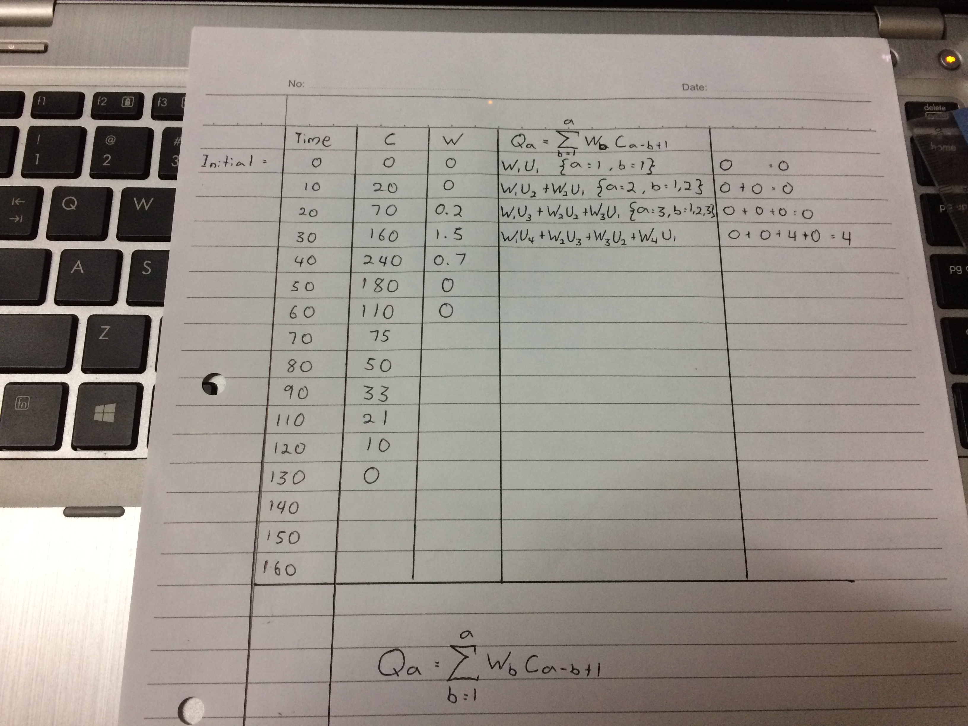

Thank you for helping me
But I'm still have a lot of problem
The reason I don't use excel because main topic is to use VENSIM as dynamic software
Here attached model update by me and hand calculation as required result
I think still need loop since in each row not used previous data or information
Can you help me on this Mr. tomfid?

Re: How to solve this type of equation
Ahh ... if the summation is also time varying, there's no practical way to do this in PLE.

Can you help me complete that equation using my file because I want try to run in DSS or Professional trial version first as consider to buy that software?
I really wouldn't recommend Vensim for this task, unless it's a small part of a larger dynamic model. There will be a significant inefficiency, because arrays are static. You would have to create an array with the full dimension of "a" which would then be empty 50% of the time, and there would be a lot of overhead for something that's otherwise quite simple. You could do this in Python for free with just a few lines of code, for example.
I don't have time right now, but could work out an example later today.
