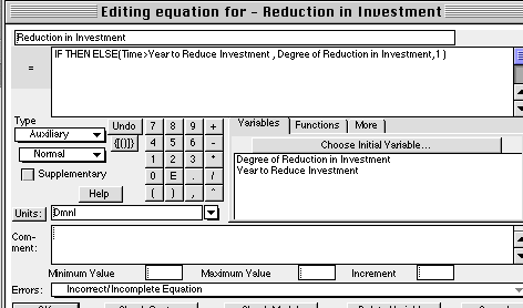

I have a general question on the function IF THEN ELSE, when it is compared to a certain stage in the run time.
How do you get the time "variable" into the equation properly?
It is probably a minor thing, and yet I couldn't find something in the manual.
Thanks a lot and best regards
Ralf
Ralf Lippold
bob@vensim.com
Posts: 1107
Post by bob@vensim.com »
To do this use the Shadow Variable tool to add Time to the sketch as a shadow variable and then draw an arrow into the variable.
Ralf
Posts: 69
Joined: Sat Jul 29, 2006 8:27 pm
Post by Ralf »
Thanks Bob for the quick help:)
