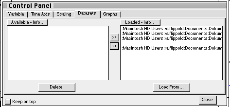

working with a Vensim version under MacOS Classic I sometimes get strange behavior.
So this time (a couple of times in the past actually) I have run different sensitivity runs and saved them via the Save-Symbol besides the RED STOP sign while doing the Synthesim.
After that I saved the model on a new folder (to be not confused later on) and got the following in the data sets:
A flaw just in the "old" Mac-Version or a general topic?
Thanks for advice on how to handle that strange behavior.

Different runs, model saved under new folder

Hi Ralf,
When you save a model to a new directory whatever runs you had are in the original directory and when this happens the full path is displayed for the loaded runs. Normally I simply unload those runs and start fresh in the new directory or move the runs across using the file manage.
The odd names are just the way Vensim stores patch on Mac classic.
