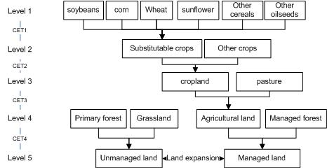

Hi bob,
I have an allocation problem that I am trying to solve using the "allocate available" function. However, after reading the manuals I can't really understand how it works and implement it. This is my problem:
I have to allocate "total available suitable land" between different land uses based on land rents (ppriority) and respecting a hierarchical structure of land-use conversion elasticity. However, I have different levels of allocation based on different land-use categories that are inclusive one into the other, as follows:
Total available suitable land = [unmanaged land; economic use land]
Unmanaged land = [primary forest; grassland]
Economic use land = [agricultural land; managed forest]
Agricultural land = [cropland; pasture]
Cropland = [substitutable crops; other crops]
Substitutable crops = [soybeans; corn; wheat; sunflower; other cereals, other oilseeds]
I have tried to define the allocation function as follows:
Land share[land-use type] = ALLOCATE AVAILABLE (land demand [land-use type],
priority[land-use type ,ptype], available land)
The pprofile is defined based on a constant elasticity function so that ptype=5, ppriority=land rent, pwidth=????, pextra (constant elasticity of transformation-CET)
The CET is an indicator of the difficulty to convert land from one level to the next one. So, when CET=0 no conversion is possible. The bigger the CET the easier the land conversion between levels. CET1>CET2>CET3>CET4 so that it is easier to convert soybean land to corn that to convert primary forest to agricultural land. CET constrains priorities to land share representing the producer behaviour of using first the most productive lands.
Questions:
What does x mean in the constant elasticity function: q(x) = q0 * (x/ppriority)^(-pextra) if x > pwidth
What dose pwidth means?
Land demand is a variable, so, how do I define it as so in the allocation function?
Land rent is also a variable, so, the same problem arises.
I have a problem adding subscripts: when I define the variable as subscripts the variable disappears from the model ! I not sure I am using subscripts in the right way. For example, land demand [land-use type] should be a vector of the sum of the demands of each land-use type of that level (e.g. land demand [managed land]=agricultural land demand + managed forest demand), where agricultural land demand and managed forest demand are variables (inputs to the managed land demand).
Allocation function: do I have to define a single allocation function that allocates the "total available suitable land" respecting the hierarchical structure of land transformation priorities or do I have to define allocation functions for each level and then link them based on the hierarchical structure?
I can post the model and the hierarchical structure if you need.
I hope you have understood and you can help me !!! Thanks a lot !
Luis
[Edited on 1-21-2010 by Panichel]

- Drawing1.jpg (20.31 KiB) Viewed 19638 times

From what your describe, constant elasticity is probably not the best choice, but I believe there may be a bigger issue at play. The migration of land from one use to another use occurs over time - the allocation logic needs to be working on the rates that change this level, not on the level directly (unless you are assuming some sort of equilibrium). The difficulty of moving from one use to another should be captured outside the allocation logic, it should actually be an input to the price/priority.
It would probably be useful for you to work through Chapter 17 in the User's Guide to get a better understanding of subscripts. For this particular problem it would appear you need
crop : soybean,corn,wheat,sunflower,OtherCereal, OtherOilseed
The allocation of the crops is then accomplished by using cropland - other crop land requirements as the available supply. Everything else seems like it would be a variable, and not a subscript. You could have allocation at different stages - managed land can migrate from agriculture to forest (both levels) depending on the relative value of the two. Using the ALLOCATE AVAILABLE for this would be possible but might be more confusing than useful.

Hi Bob and Tomfib !
Bob: I have tried with ALLOCATE AVAILABLE but I applied it to the whole “managed land” because I did not knew how to allocated land between the other land uses then. I have defined an aggregated stock of "managed land" where land shares of the “managed land expansion rate” for each land-use type are defined based on priority [land-use type](land rent*transformation elasticity), “demand[land-use type]” and “managed land expansion rate”). However, "managed land" increases at the rate "unmanaged land" is reduced, so, it is not constant. The Alloc available function should allocate "managed land expansion rate" between different land-use types aggregated in "managed land". The problem is how to determine the “managed land expansion rate"?? This should be a function of market pressure on agricultural land expansion. In fact, I do not think I am getting what I want with this formulation.
What I want to model is the relative land-use change between different land-uses (i.e. if soybean land expands, where is that land taken from and where is the displaced land relocated?) I was thinking to define a land-use types*land-use types matrix of relative priority and treat the problem as a market share allocation problem, where “managed land” is a variable increasing over time based on market pressure for new agricultural land. But, as “unmanaged land” don’t have a land rent, I am not sure how to model agricultural land expansion. What do you think?
In any case, here is the model with Alloc Available applied to the aggregated managed land. I have a problem with this: I get an error (expecting an operator) in “land rent” and “managed land attractiveness” I have defined a pprofile subscript to define attractiveness that is the same for each land-use type, with exception of the priority. I have chosen a Normal ptype function.
I could not make the model run yet because of this problems (expecting an operatior, incomplete number of subscripts, subscript rage do not appear on the left), so I couldn’t analyse behaviour. Can you please take a look to this problem?
Tomfib: Yes, I want to have stocks of each land-use type, that is (soybean, corn, wheat, sunflower, OtherCereal, OtherOilseed, OtherCrops, Pasture, Managed Forest, Grassland and Primary Forest). That is the independent land-use classification. Then I can aggregate for example, grassland and primary forest in "unmanaged land". Then, based on land rent of each land-use type and transformation elasticity (measures the elasticity of land conversion between different levels) I want to estimate land-share for each land-use type. So, now I will try to disaggregate "managed land" in the different land-use types.
