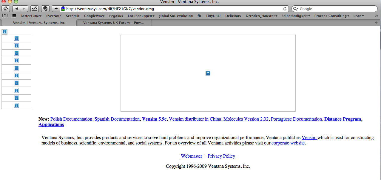

Hello Bob,
Thanks for having made the Mac-version available also for MacOSC:-)
Downloading the HTML file of the manual (to embedd in the application itself) doesn't work.
Any trick on that to do?
Best, Ralf
Best, Ralf
Ralf Lippold
Manual in HTML
.... just the recent screenshot of what appears after pressing the download button.
Best, Ralf

Thanks for the notes anyone using the OSX version should be sure to send me an email and ask to be put on the email list. A new version 5.9ex4 went up yesterday (Feb 11). I believe it fixes the problems described so far in this thread.
BTW there is no problem opening the Business Dynamics models that I can find, but there was a problem opening models on CDs and other read only media/volumes.
