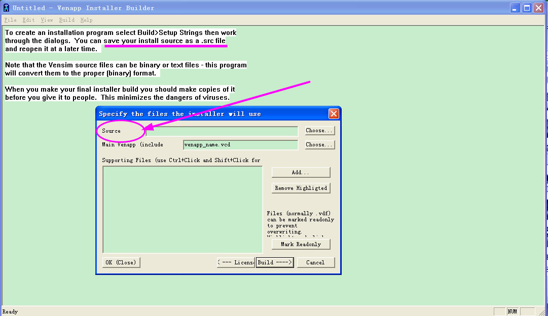

thank you but I mean :
if I have a model created in vensim DSS
how to crea the ".src" file?

Post by bob@vensim.com »
User File>Save from the install builder.

after the instraller has been created,show the information as the graph below.
but I already install the vensim dss and the venapp instraller buider in the same directory:
D:\Program Files\Vensim\InstBld
You need to check the radio button for "Build standalone application.." on the Setup Strings dialog.
