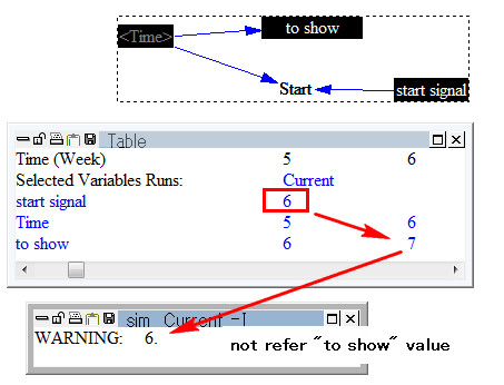

Thank you see my model
To show my trouble.
I attached capture of simulation.
I find to change "integration type" Euler to another
will change the message value correct one.
To use Message function, integration type selection
is important?
Yusuke tarumoto
To show my trouble.
is important?
Yusuke tarumoto

Hi Yusuke,
You have uncovered an interesting deficiency in the use of the MESSAGE function. During equation ordering the displayed value coming out of the message function is not considered. This means that the variable "to show" is not computed until after "start" is already computed so the MESSAGE function get the old value for this. You can work around this by being sure that the equation with the MESSAGE function is embedded appears last alphabetically (starting with a Z if only alphabetical characters are used or you will need to just look in the variable list to see what is latest if you are using Japanese).
