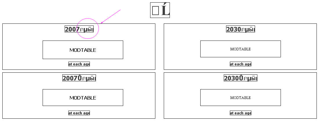

but there are many Unrecognizable Code?

My best guess is that the venapp source is using a different character encoding than expected. By default Vensim uses UTF8 but order versions would use the local encoding. Try Models>Convert Charset and then select as the originating encoding Chinese, Simplified and as the output UTF8 to see if that works.

Post by lynchyml »
it works
