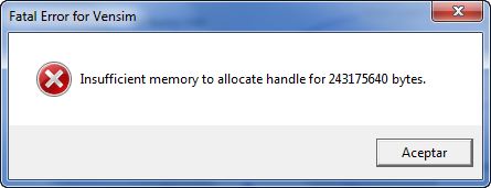

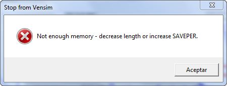

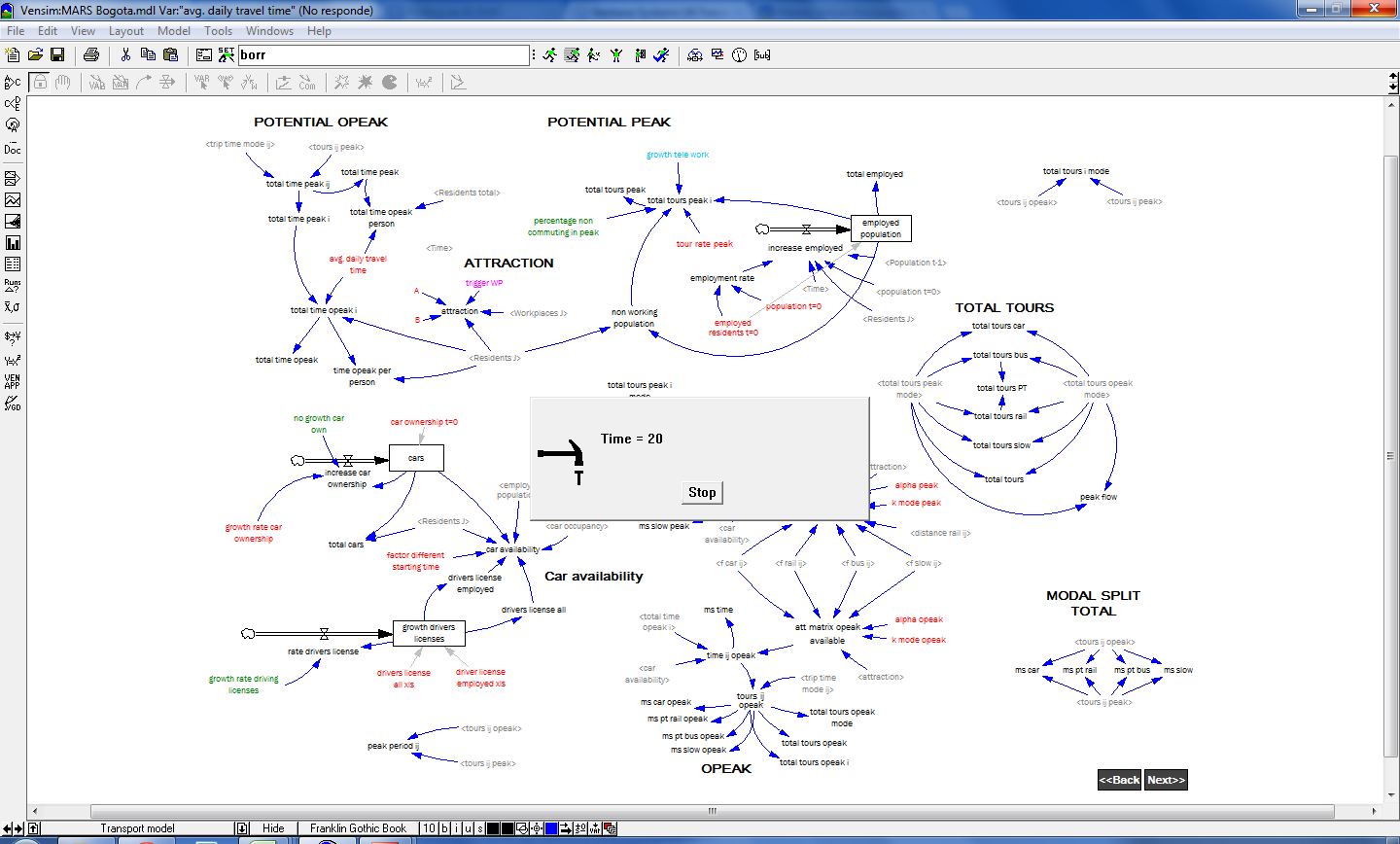

Hi, I was trying to simulate my model in Vensim, but I couldn't. My model have 124 x 124 matrix and 4 subindex (as maximum), time step=1 and time between 0 to 30. After final time=30, the error message is: "Not enough memory - decrease lenght or increase SAVEPER".
Then I try again with final time=20, and then appear "insufficient memoty to allocate handle for 243175640 bytes". Or the software held in the window time=20 forever and says "not response".....
So, how can fix this? Thks!!

Ok, thank you Tony. So, it is impossible to expand the memory?
Posts: 4838
Re: Not enough memory in Vensim
It is impossible for now as Vensim is a 32 bit application (limited to 2gb total RAM).

Well, i would not mind that model executes slowly. The model info is the following:
Model info
Model info
Posts: 3994
Right. This is probably going to take about 120MB per step. It might run with a long SAVE PER, but that'll make it hard to debug. Sorry.
