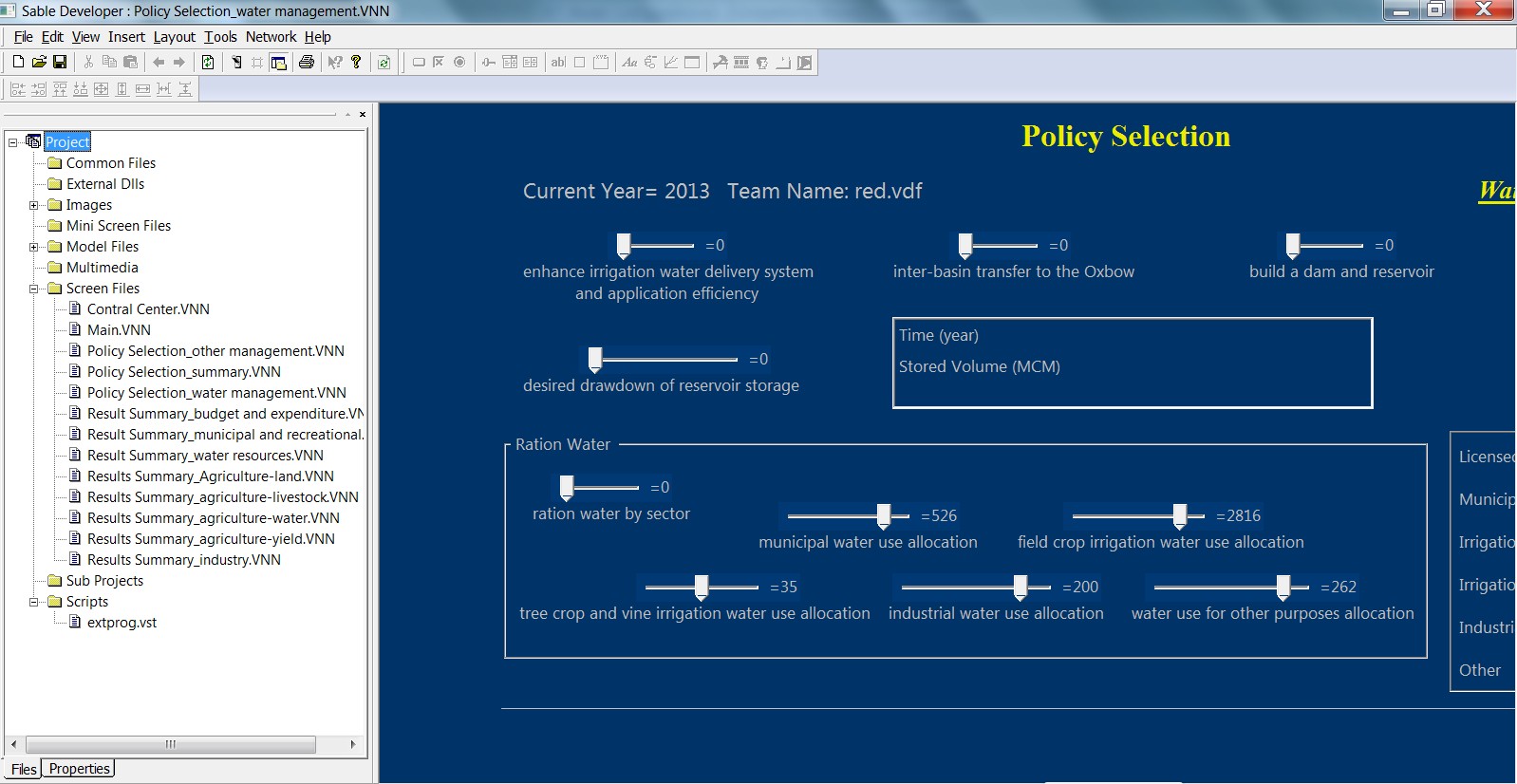

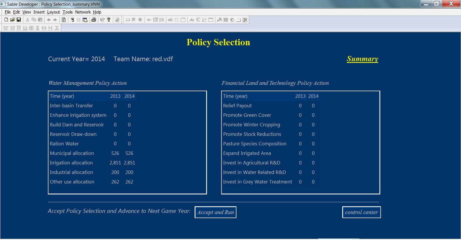

The screen of "Result Summary_budget and expenditure" represents the first and second problem. In this screen, I want the table to display values with comma (first problem); I also do not want the table to show the results of 2019(current year), because I didn't run the simulation for this year (second problem).
The screen of "Policy Selection_water management" represents the third problem. In this screen, I want the player can only build a dam and reservoir one time in each game (slid the slider from 0 to 1, and then disable this slider).
Thanks for your reply.

3rd problem. Create a directory called "Scripts" in your project directory. Save the file extprog.vst in there. Now load up the screen that I've also attached. When the slider is moved, the script is called and the value is checked. If it is 1, the slider is disabled.

For the second one, let me put it in this way. If I start a game (annual time step), the first year is 2013 and the last year is 2028. I run the first year simulation(2013), sabel will give me the results of 2013 and 2014, even thoug I did run the 2014 simulation(second problem.jpg). Next, I run 2014 simulation, then the results of 2014 will be changed according to my simulation and the results of 2015 will also represent. Vensim also does it in the same way, I made a simple vensim model to explain this problem(second problem.mdl). You can run this model in the game mode to see the problem.
For the third one, I tried what you told me but it didn't work. I am not sure if I did correctly, I saved a picutre of the project workspace,please take a look.
The first problem is Ok now.

I really do not understand what the 2nd problem is. You mention that you run it until 2014 and it shows the results, that is what it should do.
Did you use the screen I uploaded to only allow the setting of the slider once?

Based on the graph of the second problem, the current year is 2014, that means I am standing at the begining of 2014 and preparing to choose some policies for this year. When I am happy with the policies that I choose for the year 2014, I will run this year's simulaion, after that I should see the results of 2014 and move to the begining of 2015(current year). The picture(second problem.jpg) was saved after I run the 2013 simulation (I did not run the simulation of 2014 yet).
I did use the screen that you sent to me and found that there is no difference from my original screen. Are you sure you sent the edited version to me?
Best,
Kai

I think this is just a difference between continuous and discrete time thinking.
You could try creating a TIME BASE that's shifted one year for display purposes, or switch to the Diff integration method, which changes the timing of display of stocks vs. flows.
