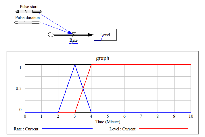

Dear Tom,
I also have such a problem. In my model, I should have a rate which inserts flow to a level.
I could not understand why there is delay between rate and level (the level behaves ONE Timestep after rate).
In contrast to "oludot5", I should use the level here because I need to save the accumulated values here.
Is there any way to avoid this imposed delay? Or fixing it or adjust it? This delay propagates through my model because I have several Interconnecting rates and level.
Thank you very much
Thank you very much
- Rate 2 Lelel DELAY.PNG (19.95 KiB) Viewed 11082 times
- Rate 2 Lelel DELAY.mdl
- (1.8 KiB) Downloaded 515 times
Re: time deley
A time step lag in state updates is a pretty fundamental property of ODE systems, not to mention real physical systems. What are you trying to model that requires cascading instantaneous updates?

Dear Tom,tomfid wrote:A time step lag in state updates is a pretty fundamental property of ODE systems, not to mention real physical systems. What are you trying to model that requires cascading instantaneous updates?
I do apologize due to my delay in answer.
Due to your question regarding my model (which needed that Level act simultaneously when Rate injected without TIME STEP lag.
Here I have three activities:
Both Activities A and Activity B that their start is triggers by a Mile Stone Called “Mile stone i”. The “Initial Pulse” variable acts at the start of simulation.
Both Activities A and Activity B should finish then Activity C can start. In other words, the relation between them is FS (Finish to Start). So we suppose a mile stone than triggers Activity C when assured both Activity A and Activity B finished. Here, I need to synthesis a memory which helps to alarm just when the latest Activity (B or C) finished.
I tried to define a Level which accumulate Pulses from Activity A and B (two pulse with amplitude=1) and just when the Level reaches “2” model understands that the time is to trigger Activity C. so the Output Rate “Mile Stone i+1” activates and do Empty the Level by a pulse. This pulse has a dual role:
1-To Trigger Activity C to Starting.
2-To empty the Level. It needed to be empty at each processing cycle to be ready for next processing cycle.
Other steps are not under question the Activity C acts as its delay imposed to it. To starting A and B for next Cycle, they needed to be informed by “Mile stone i”.
As you see the TIME STEP lag is imposed. I agree that in many real systems we have delay between rate and it’s following Level. But here I need to define a Finish to Start relation.
Is there any other way to avoid such imposed delays?
The trick which LAUJJL Introduced is represented bellow the main model. Which my problem remains in other side. As you see in the Graph 2. How can I generate a pulse just when variable “” gets the peak?
The peak, here, is not an event and it has duration!
