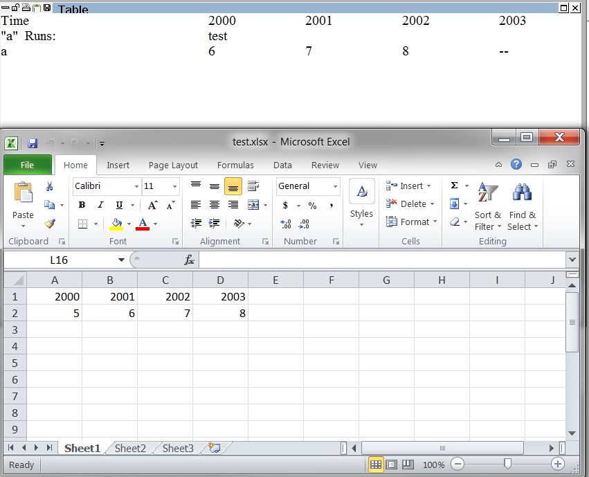

2. I am trying to use the function "GET XLS DATA" to read some time series data from an excel file into the model. When I run the model in the "GAME" format, the model results (figure 2 up) does not match the values in the excel file (figure 2 down). I also attached a simple example to show this. Run the model "test.mdl" in the GAME format, and compare the results with excel file, you will find the problem showing in figure 2.

There does appear to be a storage or display issue with the GET XLS variable in gaming mode. However, if you add an auxiliary, b=a, it takes on the correct values, so I think the underlying sim is OK. I'll investigate further.
