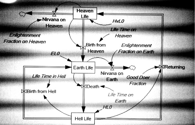

My model has long delay and short delay constants. The time horizon is [0, 3.3e+170] years. The smallest delay is 100 years, and the largest is 2.772e+034 years. The model purpose is to test a religious belief of reincarnation, long held in many far eastern countries.
My dynamic hypothesis describes the dynamics of existing being (except flora) in a universe of the Three Worlds: the Earth, the Heaven, and the Hell, based on Buddha Gotama’s theory of Reincarnation (See the reply below).
PROBLEM
The maximum allowable FINAL TIME of Vensim is 1e+038 years, far less than the final time of my model. So, I change the time unit from Year to an ancient unit called “Kalpa”. One Kalpa equals 3.3e+30 years. The FINAL TIME is extended to be 5,000 Kalpa.
But we know that the rate of
Death=
Earth Life/Life Time on Earth
~ Ten Millions life/Kalpa
The value for Life Time on Earth is only 100 year, or 30.3e-028 Kalpa. Everything is O.K. except when running the model, Vensim stops the simulation and issues a warning message : Floating point overflow – saving to time 0.015625, possibly because the Death’s value got too large.

DYNAMIC HYPOTHESIS OF THE THREE WORLDS MODEL
People in many far eastern countries hold a common religious belief that they are in a universe of three connecting worlds: the Earth, the Heaven, and the Hell, where living things consist of human and non-human creatures who have been and will be traveling in these worlds for a long time until they are enlightened by practicing the right methods for having the right wisdom. Enlightenment makes them exist the three worlds permanently and enjoy immortality after the death in their last reincarnation.
Those who are doing bad things will go to hell after death and subjected to associated penalties. The maximum penalty lasts 1 Kalpa, or 3.3e+030 years, which applies to ghosts who had intentionally murdered their own parents when they were on the Earth. After enough punishment, they will be reborn on the earth as animals hundreds of times before becoming a poor unhappy human.
Those who are doing good things will go to hell after death too, but for spirit cleaning before going onto the celestial world, to become the residents of the Heaven. Those who have done more good things on the Earth will be able to stay on the Heaven for a longer time. The maximum heaven lifespan is 84,000 Kalpas, or 84*3.3e+033 years. After consuming all the benefit, they will be eventually reborn on the earth, to good families. While living on the earth or on the heaven, they may meet the Buddha (extremely rare event), understand his teaching, and successfully practicing, their mind will be pure and can permanently exist the three worlds after death (go to the Nirvana condition). On the contrary, if they fail to maintain doing good things, they will fall into the hell after death.
- photo.jpg (109.3 KiB) Viewed 17804 times

I think you'll have to use some other package to do this. I cannot think of a way of doing what you want.

I think it ought to be possible to simulate portions of the dynamics in double precision Vensim DSS. The largest double is something like 2^308, so the capacity is there.
However, even if it could run, you have a problem, which is the cause of your fp error. You're running for 5000 kalpas with a time step of 3e-28 kalpa, so you're attempting about 1e30 time steps. You could hand code your model to avoid memory issues with that, but even with a petaflop of computing power, it'll take you millions of years to do one run.
I think the best you can do is:
- eliminate the Earth from the system, because its time constant is so short that it's nearly always in equilibrium with respect to Heaven and Hell, or
- solve the whole system analytically
JJ's suggestion, adopting representative delays on a more reasonable range of scales, might be a good way to start by getting some intuition.
My tentative observation is that, to generate the observed throughput on Earth, the stocks of souls in Heaven and Hell would have to be mind-bogglingly large.
