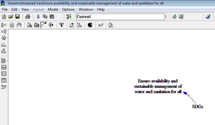

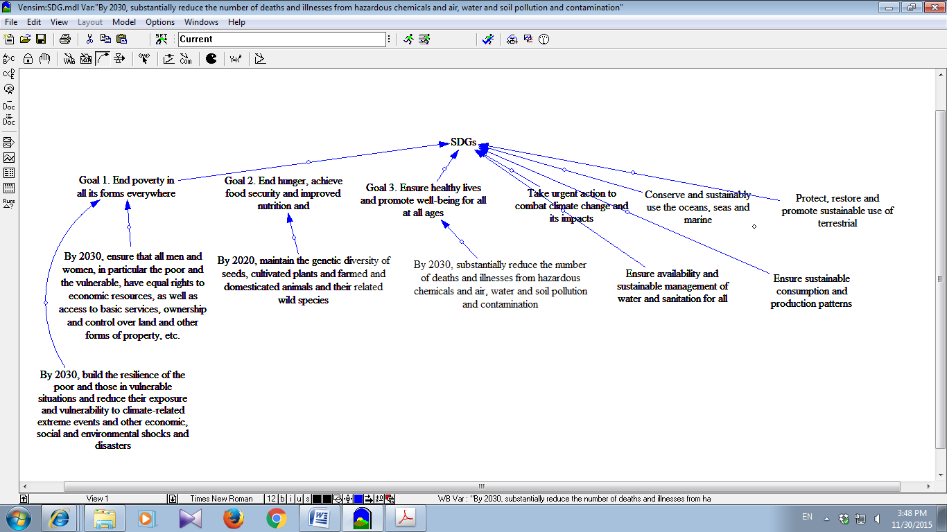

Dear Administrator,
For all Vensim configurations (PLE/PLP), model components (especially text) in the Sketch drawing area is blur. This occurs every time, even in different PCs (Windows 7). To solve this problem, I minimize the window and then maximize it. Could you help?
Best regards,
Monte

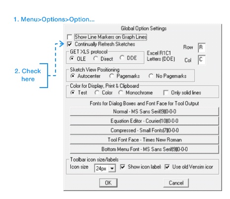

It's a problem of font smoothing.
You can try Options->Options and tick "Continually refresh sketches". That forces a redraw each time you make a change.
