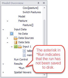

Runs can only be reloaded from saved results files, so if a run was not saved to disk prior to unloading, it cannot be reloaded.
Ventity indicates which runs have not yet been saved to disk with an asterisk in the Model Overview:
Would a pop-up confirmation when attempting to unloading unsaved runs be useful, or annoying?

Thanks, that makes it clear. I would not include a popup-menu, but describe the issue in the help menu. I just had a look at the help menu (search term "load") and found that it is described well there. I just didn't find it before.
