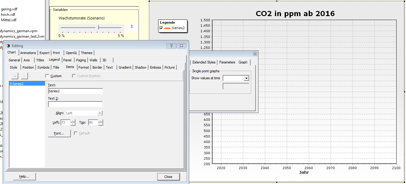

I have a probleme with the Legend in one of my Graphs.(look at the picture upload). I think i have the same options/properties in every Graph, but only in this Graph is always "Series2". Do you know how i can fix it?
I want only the Simulationruns in the Legend ("Series2" isn`t a simulationrun)

It looks like you might have accidentally added a custom series. Can you upload the screen file and I'll take a look?

Here is the screen-file.

Does the attached file work ok for you?

The file didn`t work, but i fixed the problem meanwhile.
