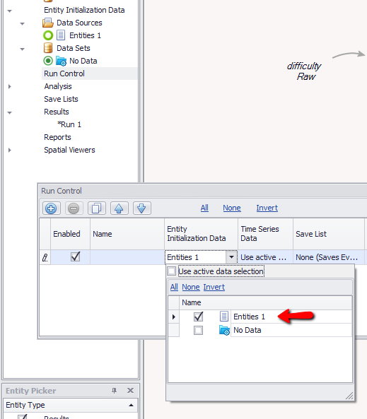

In Run Control
I cant change the "entry initialization data", always reverts to "use active dataset".
Posts: 4003
Re: Cant change dataset in run control
Does your data selection look something like this?
Be sure to click outside the panel after making selections; if you hit <Esc> it will revert to the previous setup.

I am experiencing this problem too - and clicking outside the window doesn't work.
(I am running Windows 10 64 bit, have installed version 1.01, but the About screen says I am running 1.0.)
Trying various things - ctl-enter etc, I notice that if I hit the "Windows" key, then return to Ventity, it works.
Posts: 4003
Sorry about that - I've seen the bug, but thought it was fixed in 1.0.1. We'll get a release out ASAP.
