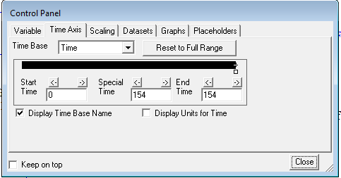

How do I set my model to run in months using the old version 5.5 DSS? I mean, I would like to display for instance from Jan-2005 to Dec-2016 instead of from 0 to 143. As you can see in the attached file I don't have the option to tick "As date" at the Control panel nor the "Format" date at "Time Bounds" tab.

- Control Pannel.PNG (7.44 KiB) Viewed 8922 times
- Model Settings.PNG (9.62 KiB) Viewed 8922 times

I already have done it as you can see in the attached file I have sent previously. The model is running in months but what should do to show YYYY-MM (or some format close to this) on the graphs instead numbers set on the INITIAL and FINAL TIME field?

Ahh, so you don't want the model to run in months, but display months on the graphs?
I don't think you can do it in your version of Vensim (it's too old).

Re: Time Bounds Old Version
PLE won't help. The problem is not that you can't adjust the setting; it's that the feature doesn't exist at all in your version.
