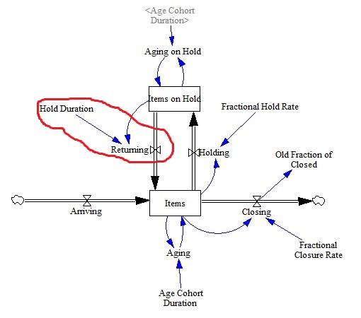

Hi Tom,
I came across an old post where the question raised was almost exactly the one I am having now and you gave a very enlightening solution using arrays. I have attached it here for easy reference. And the post is: viewtopic.php?f=2&t=5287
Essentially, the situation is about taking out some items from an aging chain, and keeping them "on-hold" for a certain period during which they keep aging as usual (as if they were still in the original chain). After the "on-hold" period they are released from hold and put back into the correct age positions of the chain. Multiple-hold is allowed.
For example, on a certain day, I take out 3 items with ages of 2,3,4 days respectively, they are hold for 5 days, then released and put back to the chain. Since now these 3 items are 7, 8, 9 days old, they should rejoin their peers who were also 2, 3, 4 days old 5 days ago and are 7, 8, 9 days old now. And so on.
However I found one component of your model a bit confusing. In fact it is also the particular issue that I cannot find a proper solution for my own model. It is the use of first-order delay for releasing the items on hold and letting them return the chain. See the red circle in the figure. Why is the first-order delay appropriate here? By using it, the "hold duration" is taken as the average hold duration, implying that items (with the same ages) may be held either longer or shorter. But here the requirement is that the hold duration is exactly the same for each and every item on hold, e.g. 30 days in the attached model.
Perhaps my interpretation of your model is inaccurate. Please could you offer some insights?
I know the original post and your model were back in 2013 and Vensim has been advancing since then. So, I wonder if there is any alternative solution to this issue, still in the context of Vensim (not Ventity).
Many thanks for your time.

I think the difference is simply a matter of focus - this model is the continuous version, that doesn't worry about individual items.
I guess you could use an infinite-order delay here, to hold the items by an exact time, and then return them to an appropriate (later) slat in the delay chain. In that case, you wouldn't need to worry about the aging process for the held items - the stock of items on hold would really only be there for accounting.

Hi Tom, thanks for your suggestion. However, I do not think that solves the problem, because when those items are being on hold for the required period, they shall keep aging as usual rather than being "frozen". If an infinite-order delay is used, the outcome is that a 5-day-old item entering the delay (say, hold for 10 days) will still be 5-day-old when leaving the delay box, but it should be 15-day-old. Moreover it is also possible that items on hold may experience some % of scrappage every day.
So I think the explicit aging process for items taken out, as shown by the "Items on Hold" and "Aging on Hold" in the above picture, is still needed. The problem is how to tell Vensim the hold (the duration of aging in the "Items on Hold" box) is 10 days (or whatever number desired).
Could you offer some further advice please? Many thanks.

You could map the return flow from age x to age x+d of the main stock, right?
