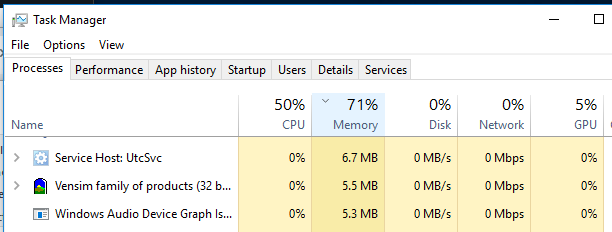

I am worried that perhaps we are running into some limit in Vensim on how many variables or fields can be addressed in memory. But my computer's RAM isn't the issue. When I load the Energy Policy Simulator in Vensim and check Vensim's memory use in Task Manager, it is using only 5.5 MB:
Vensim memory usage during normal operation
