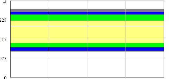

I simulate my parameters, but in all graphs the intervals are constant.
Estranged!
Estranged!

What is shown on this plot? If it's a parameter, it will be constant.
