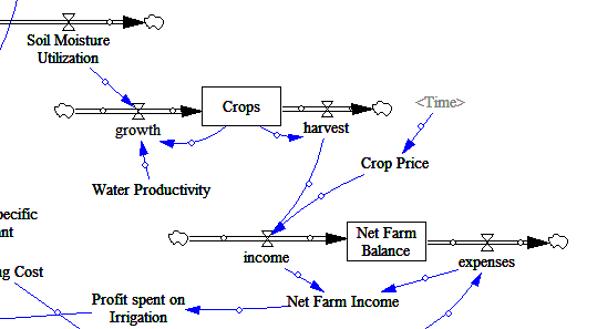

1. I think the model would be clearer with more physical variable names and concepts. For example, "yield reduction" is not a thing. You want to model the physical state, which is - I think - the amount of crops in the field.
2. I'm not sure why TIME STEP is in the denominator for Yield Reduction. Generally, TIME STEP should not figure in equations. The only exception is when you want to measure an instantaneous derivative or model a discrete event. This may be the latter, but I'm not sure.
Posts: 3988
Re: Running with Different Timesteps
Combining these, I think you want something like the following:
Growth will be a continuous process, something like:
Growth = Effect of Water Availability * Crops * Normal Growth Rate * (1 - Crops/Max Crops)
Then Harvest is a discrete event:
Harvest Trigger = PULSE TRAIN( ... )
Harvest = Harvest Trigger*Crops/TIME STEP
