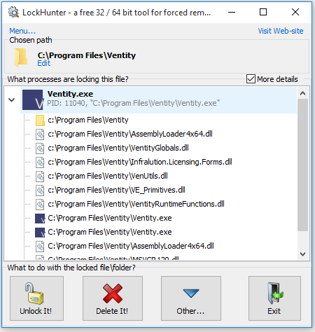

I also just tried using Lockhunter to view which processes were using the locking the "Ventity" program folder, and it seems as though only Ventity itself is accessing the folder (see attachment).

Re: "The configuration is read only" error
The problem is typically with %appdata%/Local/VentityConfig.xml.
I'll check with the programming team for other ideas.

Thanks, Tom. It doesn't seem as though any processes are locking that file/folder. It also looks as though my account has the required read/write permissions.
