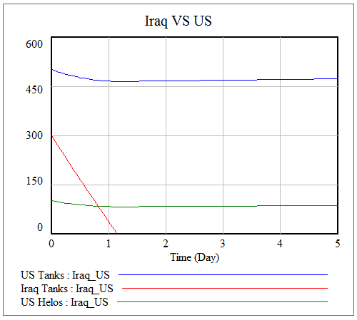

I'm working on repeat a model using Vensim PLE 6.4b (32-bit) from a paper I read, but the model I create does not match the result in that paper. In brief, I need every stocks to be zero when they reached to the zero, since I cannot get negative number in this model. I've tried to use if else then statement like this:
IF THEN ELSE(Iraq Tanks >= 0,-Iraq Tanks Attrition Rate, Iraq Tanks=0),
and I set zero as the minimum for those stocks but it won't work.
Is there any way that I could ask Vensim to avoid getting negative numbers? Thank you!

Generally the constraint to impose is:
Often min time to drain stock is equal to time step for convenience, so you can use the following shortcut:
Stock = INTEG( inflow - outflow, init stock)
init stock = ...
inflow = ...
outflow = MIN( desired outflow, max outflow)
desired outflow = ...
max outflow = stock/min time to drain stock
outflow = MIN(desired outflow, stock/TIME STEP)

Re: Stop When Reaching to Zero
Another, perhaps simpler way to do this without adding in a new auxiliary variable (desired outflow) is to modify the equation for the stock from:
to
Stock = INTEG(max(inflow-outflow,-Stock/TIME STEP), init stock)
An equally simple limit is:
outflow = MIN( desired outflow, stock/TIME STEP )
The assumption here is that the dynamics of the constraint are not of much interest, so that it's OK to assume that the minimum outflow time is equal to TIME STEP. This is usually fine.
This avoids having TIME STEP as an input to the stock on the diagram.

Thanks for the advice. I guess it is better to have TIME STEP as an input to the flow on the diagram.
