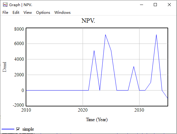

When I run the model, the system report error that FIND ZERO did not sufficiently zero. It is shown in figure of NPV

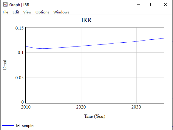

My understanding is that when FInd zero cannot find 0, we cannot calculate the IRR. But such a huge difference (the figure of NPV) does not affect the IRR result graph, so, I was wondering what's wrong with that?
In the above figure, the profit as a fixed value. I uploaded a simple model that how I calculate the IRR by FIND ZERO function, when I use random funtion to as the profit, a result of NPV has very large negative value. But from the profit of the input data, and the result of the calculated IRR does not reflect such a different difference.

I think the problem is that this is numerically cranky as formulated. Your NPV has a scale ~ investment, i.e. billions, while your x scale parameter is set to 1. Zeroing the npv to the nearest dollar is hard (and a waste of computation since the prospective NPV of a project is never certain).
Set x scale to 1e9 and tolerance to something like 100 and it works fine.
A more general approach might be to compute frac err = NPV/investment cost, and zero that in place of NPV. That way you can use parameters like x scale = 1 and tolerance = .0001, which seems more natural.

It works, thank you very much.
