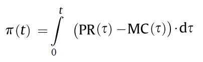

Hi, everyone
From the literature, I see that many people use integration to calculate annual profits
Looks like:
Because I used discrete points to calculate daily profits, and then accumulate annual profits.
But the more discrete points are set, the more troublesome the model becomes.
Therefore, I want to try to use continuous points to calculate the annual profit.
When using the level variable to model profit, it is a cumulative profit and requires an initial value.
I was wondering is it possible calculate the annual profit without requiring the initial annual profit?
I uploaded this simple model
Thank you for your help.

1. The equation above from the lit gives cumulative profits, not annual profits. For annual profits, you need an outflow of profit from a year ago.

tomfid wrote: Mon Oct 12, 2020 1:57 pm 1. The equation above from the lit gives cumulative profits, not annual profits. For annual profits, you need an outflow of profit from a year ago.

I have double checked the literture. It is my mistake.
Acutally, the equation is to calcuate the operation profit by the price and marginal generation cost.
So according to the formula, what I actually want to calculate is the annual operating profit

The problem is that you're using the cumulative profit (operation profit = INTEG(a-b,0)) rather than the current profit as the input to the structure I suggested.
Posts: 3988
Re: How to use level to calculate annual value
Adding units would reveal the issue, because current profit ~ $/year, whereas cumulative profit ~ $.
