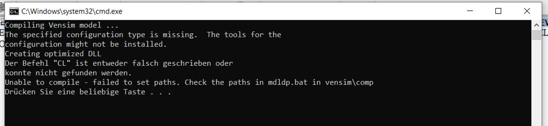

I have been unsuccessfully trying to configure Vensim DSS 8.0.9 x64 to simulate using the MS Visual Studio 2012 compiler.
Here is a screenshot of the error message that is produced:
I worry about "The specified configuration type is missing. The tools for the configuration might not be installed." What could that mean?
Also, it gives a hint that the command CL is either mistyped or unable to be found.

Line 4 from above, "call "C:\Program Files....." points to an existing file "vcvarsx86_amd64.bat". In Vensim, I configured the compiled simulation with
> Tools > Options > Advanced > Compiled simulation path > PATH/TO/MDLDP64.bat
and
> Tools > Options > Advanced > set the three ticks for "Compile"
Do you have any idea what could be wrong in this configuration? I appreciate any help or info on how to resolve it.
