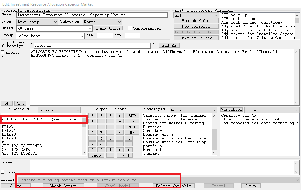

I might find why I couldn't open my model in the double precision. I copy the ALLOCATE BY PRIORITY function in my single precision to double precision. It gets errors '' Missing a closing parenthesis on a lookup table call'', but it works in the single precision.
And, when I try to use the ALLOCATE BY PRIORITY in the Functions list (double precision), the software crashed and directly quit.
I even tried to create a new model, but as long as I clicked on the ALLOCATE BU PRIORITY from the functions list, the software must be crashed.
I don't know why. Many thanks for your help.

Is one of the parameters (max capacity..., effect of gener..... or capacty for CM a lookup table?

Administrator wrote: Tue Aug 03, 2021 7:45 pm Can you upload the model?
Thank you for your reply. I only uploaded the part that was reported the error in my model.
I have tested it, the same structure, it works in the single precision.
I also download the example about ALLOCATION BY PRIORITY in the VENSIM HELP.
When I want to change to Sketch, it also reported a Syntax error.
Is it because my license has expired, and some functions of the downloaded double precision version are missing?
Looking forward to your reply, thank you.

I build a new model (only one Variable). When I want to click ALLOCATE BY PRIORITY in the Equations from Functions. The software is directly closed. The ALLOCA P and ALLOCATE AVAILABLE can be clicked.
I also test it on my laptop, same problem.
I try to download the software again. Does the existence of single precision (7.3.5) and double precision (8.1.0) in the computer have any effect?
