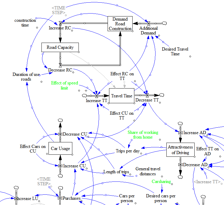

Unfortunately, I have to come back to my problem. I have started simple and elaborated step-by-step. So far this has worked quite well. However, I realized that in some cases it doesn't make sense defining variables as stocks. For example, current “Car Usage”, at least in my understanding, does not “accumulate”. The same should be true for current “Travel Time”. These should rather represent in how far car usage and travel time in- or decrease relatively (as a fraction, starting with 1 “dmnl”).
This brings me, however, back to my original problem. Let’s assume “Road Capacity” influences “Travel Time” as more roads ease traffic jams. From a conceptual view point “Travel Time” would also need current “Car Usage” as an input (which also includes the number of vehicles), but I want to keep it simple here. So, whenever “Road Capacity” increases, “Travel Time” drops, all else equal; whenever it decreases, “Travel Time” increases. So far so good.
Now, you could assume that “Travel Time” influences “Attractiveness of Driving”, which could be perceived as a stock (as you have pointed out earlier). But how should I make a linkage from an auxiliary variable (“Travel Time”), which can both in- and decrease, to a stock (“Attractiveness of Driving”). I tried to pick up on one of your earlier posts and built in a smoothening function. The stock will, however, still increase, as long as “Travel Time” is positive. In other words, it continues to rise, even if “Travel Time” decreases, only at smaller rates. This is obviously the nature of a stock. If I also create a linkage to the stock's outflow, nothing should change, since in- and outflow cancel out each other’s effect. So, what can I do to have an auxiliary variable linked to a stock and let the stock increase (maybe with some delay) when the auxiliary variable changes in one direction and actually decrease when it changes in the other direction.
Please find attached a simple version of this in Vensim. In the upper part you can see the way I tried to solve this so far; in the lower part a new sketch (I know these do not behave identically). The variables containing the “effects” are made simple here and should actually be non-linear. Also, I attach a screenshot of a section of the larger model I have experimented with so far to give some background information (variable names translated quickly). In the model you can see that I am having the same problem again with “Trips per day” and “Length of trips” influencing “Car Usage”. However, I would actually also think of “Car Usage” as not being a stock. Either way it looks a bit messy because of the way I’m trying to solve my problem.
I hope I managed to make my problem clear. Many thanks for your help!
Best wishes,
Marvin
Best wishes,
Marvin
- Screenshot model.PNG (46.84 KiB) Viewed 10388 times

A couple thoughts:
I think separate inflows/outflows to stocks are overused here. Unlike vehicle purchases and discards, there aren't obvious distinct processes that increase vs. decrease car usage or travel time.
Also, I think making car utilization and travel time coflow stocks is problematic. Utilization is a good candidate for a stock, because people can't easily change their planned utilization instantly. However, once vehicles on the road and road capacity are fixed, travel time is basically instantaneous physics.
I've attached an excerpt from a simple model we used to support discussions in California a few years ago. It's not perfect, and a little messy due to surgical removal, but may give you some alternative ideas.
