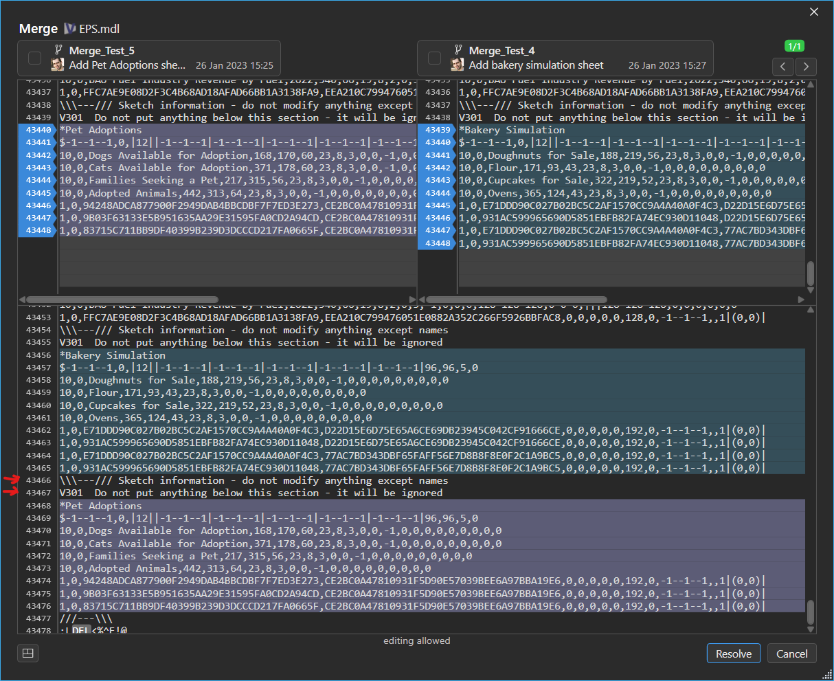

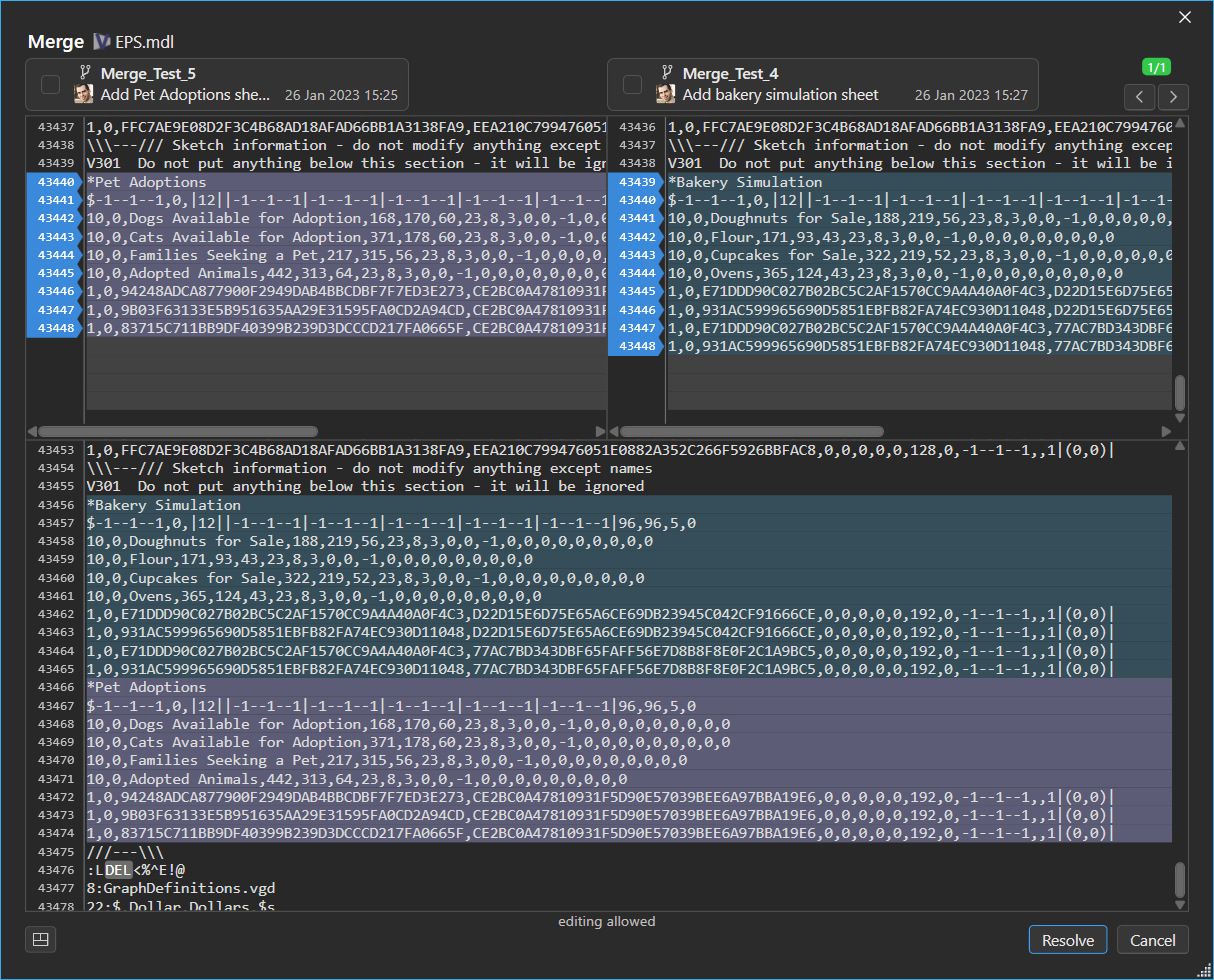

Here are the steps to reproduce the issue:
* Start with a model in the source control system and make a new branch from the latest commit.
* Activate the new branch, then open the model in Vensim. Add a new view. I called the view "Pet Adoptions" and I added some variables and arrows.
* Save the changes to the model, then commit the updated .mdl file to the new branch.
* Activate the original branch, then open the .mdl file in Vensim. The "Pet Adoptions" view doesn't exist here because this branch doesn't contain that edit.
* Add a new view. I called the view "Bakery Simulation" and I added some variables and arrows.
* Save the changes to the model, then commit the updated .mdl file to the original branch.
* In the Git client, merge the old branch into the new branch.
There will be no merge conflicts in the equations section of the code, assuming all your variables are uniquely named. But there will be a merge conflict in the display code that looks like this:
The Git client thinks these might be different versions of the same code. We want to tell it to include both code blocks, because "Pet Adoptions" and "Bakery Simulation" are completely different sheets, and we want to keep them both. To do that, we simply check both boxes (on the left and the right in the git client's merge tool), which tells the client you want to include both code blocks in the merged file (at the bottom). The result looks like this screenshot:
This almost works! It's so very, very close to working perfectly. The problem is that Vensim won't see the second of the views listed here (the "Pet Adoptions" view) because its code block (highlighted in pale purple) doesn't have the required two lines repeated above it.
It will work if we manually edit the code to add the missing lines. They are the ones I've marked with red arrows in this screenshot:
Most users will not know that they need to manually edit the sketch information in this way. They will simply include both code blocks and complete the merge. Then they will discover that Vensim does not see the "Pet Adoptions" sheet, and they won't know how to fix the problem. They will think that merging is not possible, when it really was as simple as repeating these two little lines:
