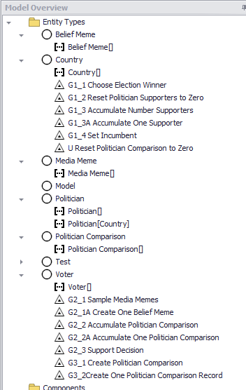

To maintain conceptual control of 13 actions so far, I used an action name prefix convention. They are organized into groups like G1, G2. Within each group the actions are sequentially organized in call sequence. Now I can much more quickly figure out what to do when evolving the model. I foresee adding many more actions and several more entities in the stage 1 proof-of-concept model.
G1_3 calls G13A. G1_3 has a lower sequence number than G1_4.
U is for ungrouped. An ungrouped action calls no further actions.
The info in the action names is incomplete. It also needs S for period start, E for period end, or M for model startup, plus sequence number. This is easily provided with a suffix convention. I'm still pondering this. Large bodies of code, even when using a framework like Ventity, can so easily get out of conceptual control unless conventions are used.

- Ventity organization of actions.png (19.76 KiB) Viewed 39286 times
Re: How to create one Comparison Sample record
This is cool. It may also be a record for most action-rich model.
