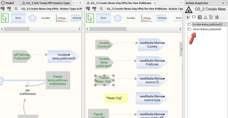

This is a two-hour puzzle. See News Org action G5_2 Create News Org MMs. The value of Invoker.temp PoliticianID is never set, as seen in the News Orgs results table. This causes many warnings.
Compare this to Voter action G3_1 Create Politician Comparison which also sets a temporary attribute value, in almost the exact same manner.
I’m using lots of temporary variables, since Ventity triggers and actions appear to have no equivalent of passing arguments in a function call. This creates a lot of clutter. Is there a better way? Thanks.

Thanks. Are we looking at the same diagram? "source type" is nowhere on News Org action G5_2 Create News Org MMs. See the image.
The especially odd thing is temp politician truthfulness IS being set.

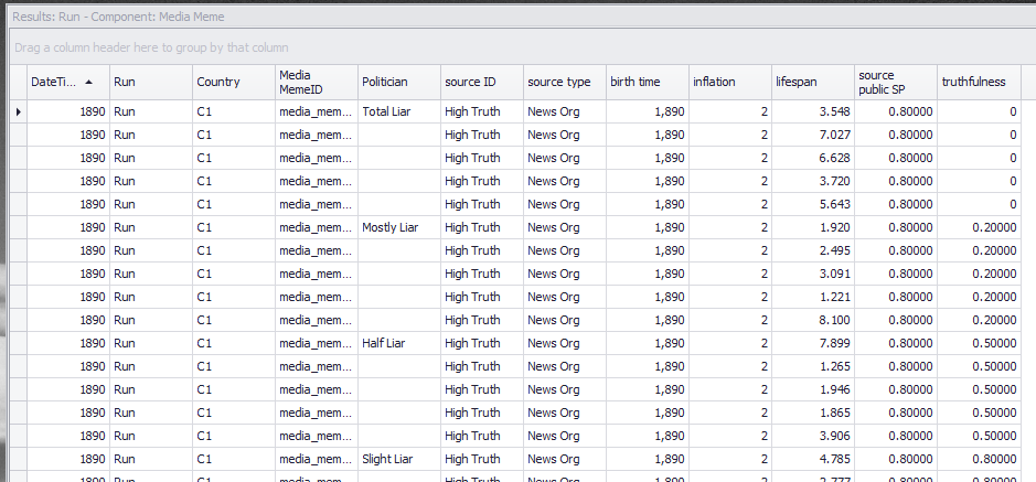

We have a clue. See the table for Media Meme. Action G5_2 Create News Org MMs calls action G5_3 Create News Org MMs for One Politician, which adds five records to Media Meme, all for the same politician. Only the first has Politician set. The rest are empty. Is it possible that Ventity is somehow losing the value of temp PoliticianID after the first of five calls?

I noticed you had shadow variables and my version of the model didn't. First I deleted two undeleted items. This made almost no difference, still got about 170 warnings. Then I started changing attributes to shadows. On G5_3 Create News Org MMs for One Politician, changing Invoker (large dot) temp politicianID to little dot with a shadow eliminated all warnings. Wow.
If use of a non-shadow causes the framework to misbehave, it seems to me it would be extremely helpful to say so in the warnings. Instead, all it says is "Unable to reference Entity Type [politician] from belief_meme [belief_meme[belief_meme_0108]] using Attribute [Politician]". This problem happens much later than what this action is doing. Thanks!
