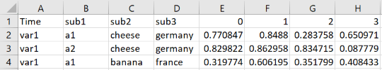

There are a lot of possible layouts, including Tidy an relational, but typically something like this is easiest:
In the import dialog, you'll specify the "sub" columns as subscripts. The range names in the first row don't matter; only the element names below are used, and some can be blank for variables that don't have full detail.

The biggest learning was to learn to use data import: Model>Import dataset....
- I note that the subscripts in the variable probably need to be in the same order as the column layout in the csv/excel/whatever.
- Once imported, the data still needs to be set as a .vdfx (or .vdf) run in the simulation control (advanced tab >> data sources) in order that it can be used to drive other variables.
