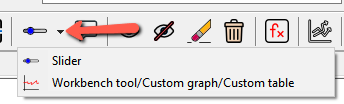

Hi Tom,
your "Building Simple Vensim Model" uses a former model version, whose tools are not identical with those of vension 10.0!
Example: you use an "I/O object" tool for input-output-object-settings which is not in vensin 10.0 visible. Where is the adequate tool?
Thanks Udo
Posts: 3986
Re: Start new models failed
We split it into two ... won't update the video until later, because there's a big update for these tools in the pipeline.
