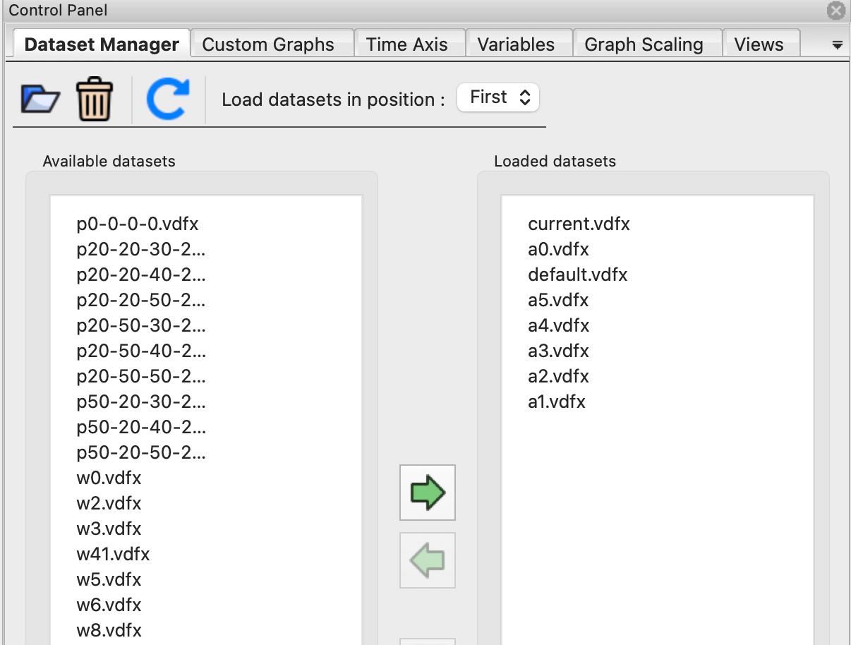

Synthesim is great and I've been using it. This is more an issue of getting back to a starting point after changing a model and running it under different names. For example, here is a snapshot of my Control Panel:
To create a graph comparing the effects of different values of [a], I did 6 runs in which I set [a] to 0,1,2,3,4,5. I called these runs a0, a1, a2, etc. Then I created a custom graph comparing the behavior of another variable when [a] was set to each of these values.
Before I started messing with [a] I wanted to save my model in its original state. So, before doing run a1, I saved a run I called 'default'.
This is the behavior that surprised me. After completing run a5, I wanted to get back to my default variable values. So I moved default to the top of my Loaded datasets list, believing this would "reload" it and replace a5. Immediately, all my graphs returned to how they looked in the default run. However, when I looked at my variable values, [a] was still set at 5 (0.5 actually). It was not reset to its "default" value of 0.31.
Now that's a trivial example. Even I could probably remember how to "get back" if I was only changing one variable in my multiple runs. But sometimes alternate runs consist of changing multiple variables, as in the "p" runs above, which alter 4 variables for each run. Sometimes its just a convenience thing. You just want to start over.
So I guess basically what I'm asking is this: If I modify a model from one state to a new state by changing variable values and saving the run under a different name, what's the best method for getting my model back to its first state, without having to remember everything I changed and reset it manually?
