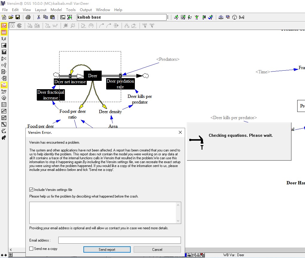

When I use v10, under new GUI, I cannot find the partial simulation anyway, I need to switch it to old GUI (under model header), but it does not work, there is always clash with error report, can you take a look? this work for previous under old GUI. I suggest to include this under new GUI for convenience. This is useful function to understand the model in small chunk.

We could not find any users that made use of partial simulation. I'll add it to the list to implement in the new GUI. Can you share a model that does not work in the old GUI for partial simulation?When I use v10, under new GUI, I cannot find the partial simulation anyway, I need to switch it to old GUI (under model header), but it does not work, there is always clash with error report, can you take a look? this work for previous under old GUI. I suggest to include this under new GUI for convenience. This is useful function to understand the model in small chunk.

1) for the model I used to do the partial simulations which fails under ver. 10, see attached. I also copy the screenshot

I'll look into the error. Did you click Send Report, we have not received it.

I just sent the error report, and had described the steps I took till the error happened

It will be fixed in the next release.
