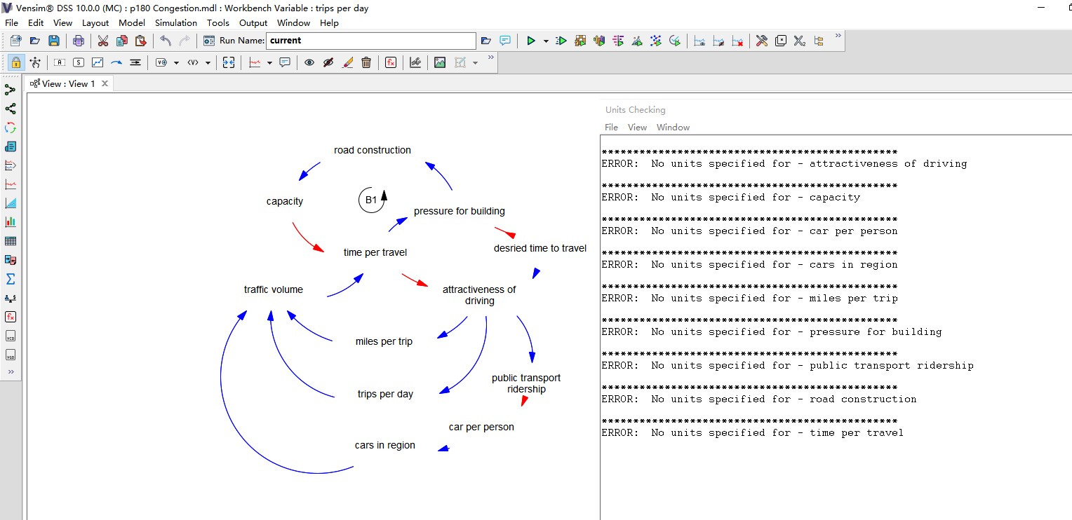

again I found the ver 10 has problem with the "Check unit" which is supposed to report those variables with no specified unit or inconsistent unit.
However, when I used the Check unit function to check my model (see attached), it prompted the variables even with the specified units, whereas it did not prompt the variables with inconsistent unit e.g. the traffic volume, trip per day, please take a look to find out.

Attractiveness of driving does not have any unit, so that is reported correctly.
The others are either correct warnings, or Vensim cannot check as there is no equation to check against.

Not so. "miles per trip" is a constant =20 and has unit mile/trip, but it's still reported as an error (no units).The others are either correct warnings, or Vensim cannot check as there is no equation to check against.
I suspect that the parsed model is so incomplete that Vensim fails to check anything, and this creates some spurious errors.

Actually, the problem with "miles per trip" is that the equation is constant, but the diagram includes a link from "attractiveness of driving" so the equation is invalid (inconsistent with diagram).
We should probably upgrade the warnings to distinguish missing equations from missing units, but either way there is a real problem with that variable.

I also did not notice the mile per trip is constant, but still interesting how can this happen if there is a link between two variables. It should automatically make constant become AUX.
Another thing I also just noticed is the number of NO UNIT is not consistent.
For example, after I changed the unit for the variable of [Trip per day] from "trip/cars/day" to "trip/day", then the number of variables with NO UNIT reduced from 10 to 9. Probably as Tom said, the checking and message has mixed up (1) no specified unit, (2) no equation, and (3) EVEN inconsistent Unit together, but it just simply shows NO UNIT.
But. After I change this unit to be the old (wrong) one ie. trip/cars/day. it still counts 9 instead of 10. seems not consistent.
Furthermore, i closed and reopened the file, it showed 11 NO UNIT. something wrong behind.

I'm not sure we should do this, because the extra arrow could be a mistake. In the language, constant and aux are actually the same in terms of syntax (both use the = operator), so detection of a constant is made by checking the RHS to see if it's numeric.
