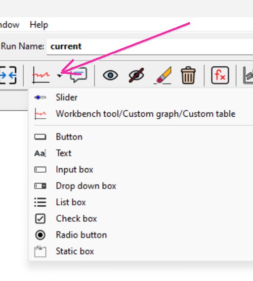

You'll need to use the old GUI in order to work with Venapps for now.
There are a few examples in the help system, search for files with the extension VCD.
Alternatively, if you are running Vensim DSS 10.1, hold SHIFT when inserting an IO object, there are a few new controls available.
