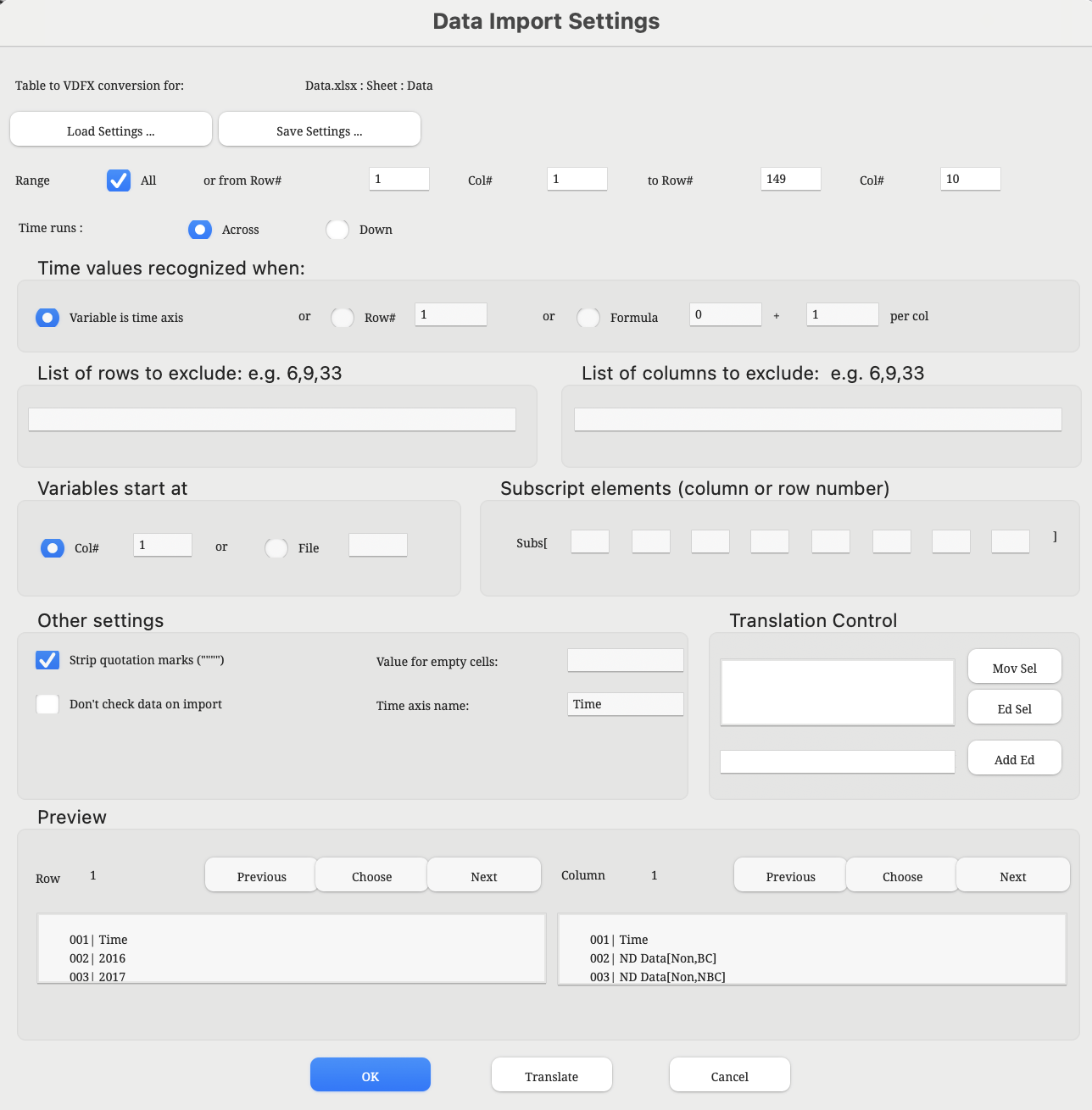

6. I feel that the Data Import Settings window has not been updated yet because the fonts and sizes are weird. But other windows like Export Settings or Optimization Settings are okay.

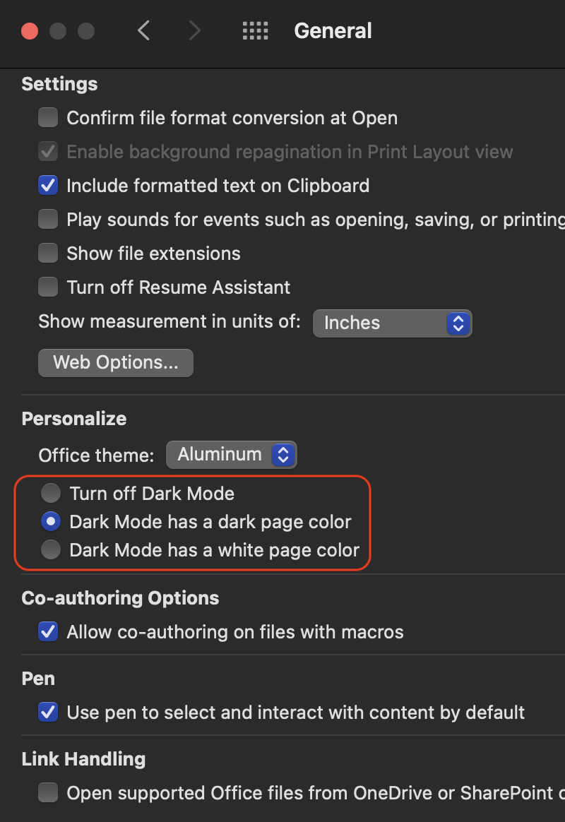

8. I’d appreciate if you could make the ‘dark mode sketch’ to be enabled automatically but include an option like Microsoft Office apps to customize that behavior

aliakhavan89 wrote: Tue May 07, 2024 3:55 pm 6. I feel that the Data Import Settings window has not been updated yet because the fonts and sizes are weird. But other windows like Export Settings or Optimization Settings are okay.
Correct. We are working on a replacement (hold SHIFT when selecting export data from the menu, you will see the replacement).

We've talked internally about this and decided on the current functionality. We spoke with some teachers that need to review models from their students, they need to be able to see the model as the student designed it rather than in a dark mode. This is why it's a user configurable setting.
