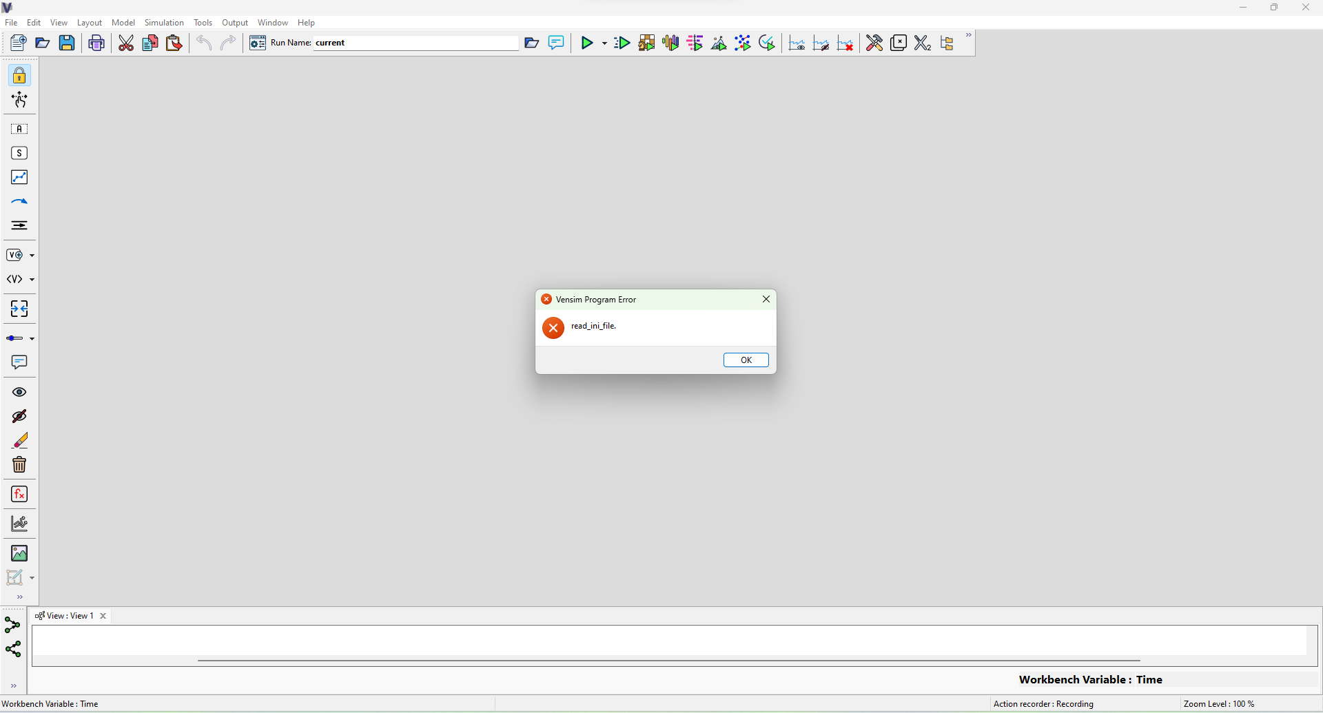

I recently have the same error when opening the model (read_ini file error). Could you tell me how to check if I am using the old or the new GUI and how can I move to the new GUI? I am using VENSIM DSS 10.1.3 (I am sorry for my simple question but I am not good at PC settings)eliotrich wrote: ↑Thu Mar 23, 2023 6:57 pm Vensim. Program. Error.

I have checked the GUI as your guidance and find that I am using the new GUI.
However the error still happens everytime when I open the model.
Is there any other reason related to this error?
- error.png (81.63 KiB) Viewed 8916 times

Can you detail exactly what you do please? Do you click File->Open, or double click in Windows explorer or something else? Also are you running Windows or a Mac with a Windows emulator?
Re: read_ini file
I am using Windows. I double click on the model (mdl file) I created before (store in Drive D). Usually, this error will appear but the model still work as normal after that. There are also several times this error does not appear even when I do the same way to open a model (double click on the model).Administrator wrote: ↑Tue Feb 20, 2024 8:21 am Can you detail exactly what you do please? Do you click File->Open, or double click in Windows explorer or something else? Also are you running Windows or a Mac with a Windows emulator?
Sometimes, when I am changing the formulation of the variables, the software suddenly crashes and closes. I am not sure if this problem is related to the error "read=ini file" I encounter at the beginning or not.
