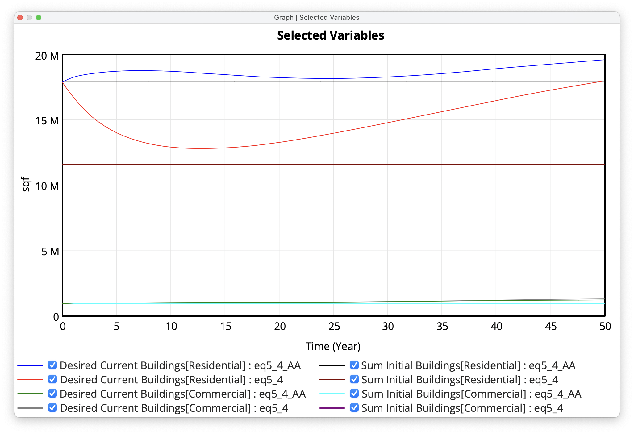

In simulating the attached model I get weird behaviors, where some 'Initial' variables are simulated incorrectly (and I get warnings for Active/Initial difference). Specifically, check out:
1- 'Sum Initial Buildings' vs. 'Desired Current Buildings' at time zero. The two should be the same but they are not.
2- 'Utility of Alternative Locations' vs. 'Average Realized Utility'. Again, the two should be the same but they are not.
I don't know what is happening, it has been a pain, and it is the first time I am seeing this type of inconsistency. Any insights on what may be going on and how to fix it?

I think the initial value for 'Impact of Affordability on Housing Demand' is causing an issue. I used the values at time=0 as initial, and 'Sum Initial Buildings' and 'Desired Current Buildings' match at the beginning of the simulation, though there's a change in model behavior.

Thanks so much Alireza; that initial value was not needed and removing it indeed solved the problem!
