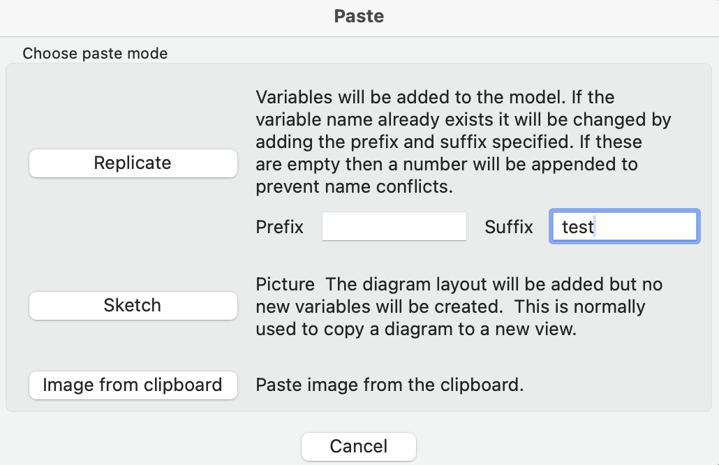

You can replace the numerical sequence with a manually defined suffix when pasting the variables, if this is what you want.
Screenshot 2025-01-21 at 5.13.00 PM.png (110.85 KiB) Viewed 5940 times
