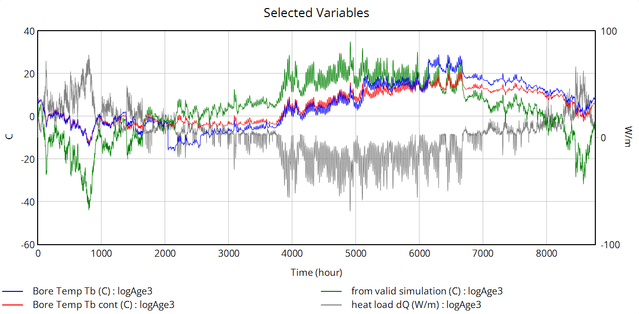

I ran a valid-ish comparison with new g-functions. It is not quite identical, in that I am comparing the fluid temperature (from valid simulation) to the borehole wall temperature, but the trend should be similar. I would need to spend some more time with manual data entry and calculations of the fluid temperature in the Vensim model for greater accuracy. Overall, it appears that there are some problems with the borehole wall temperatures from the log memory model. I am not really sure why there is a sudden spike in temperature for the Bore Temp Tb at 6000 hours, for example. Overall, with ongoing cooling operations up to 6000 hours, it is promising but this method needs a bit more analysis before it could be considered reliable.
geo_curious
Posts: 146
Joined: Tue Mar 14, 2023 2:05 am
Re: Suggestions for Temporal Superposition
Post by geo_curious »

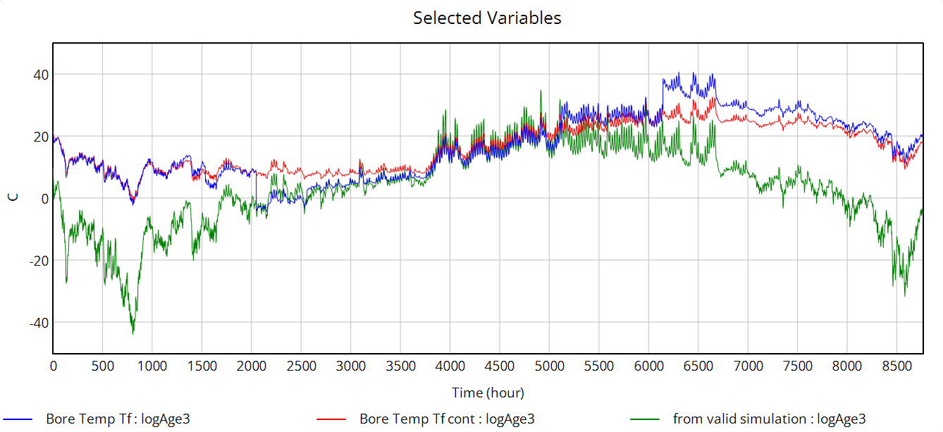

Here I have roughed in the fluid temperatures from the log memory 3 model and compared it to a valid simulation run. It is odd, the valid simulation tracks sometimes with the assumptions before the relationship collapses. There is something a bit convoluted about this comparison, however, in that the heat of rejection and absorption from equipment are included in the valid simulation. That does not necessarily relieve the log memory 3 model outputs of their mismatch, however.

I am uploading a modified copy of the valid data and the modified log memory 3 model. Looking at the original subscript method created, it is hard to match anything in Vensim to the existing industry software output. The quest continues, I guess.

Kidding of course, but seems like part of the difference must be initialization. In the HourlyOutputs, column B2, fluid temp starts at 9.58 C, which seems to be the same as Tg=9.6C. But if Tf=Tb+qn*Rb, adding about 12C, the model starts at 21C, and cant match.
Also, I suspect that the resolution of my log-spaced time buckets may be too coarse, but that's an easy fix if the systematic part can be worked out.

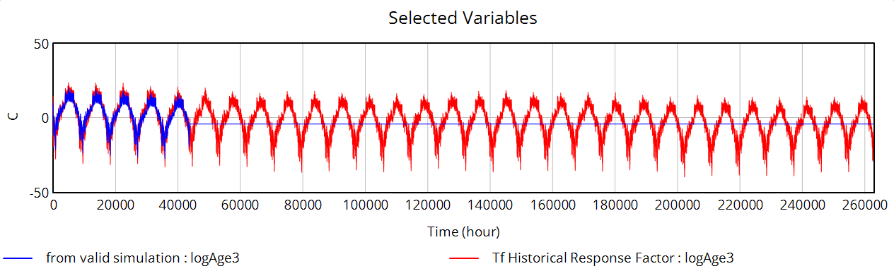

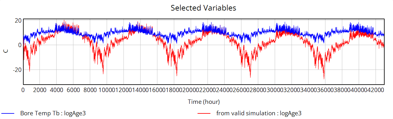

I worked on a few things within this and found an error in an equation for ts, where a_s should be in Joules, not kJ. Otherwise, none of the models actually work. It is apparent that the temporal superposition is not being respected so there is effectively no trend up or down in the temperature over time. That is an impossibility for these systems. Returning to the 5 steps to success:
1. Take in two auxiliary variables as lists of outputs up to the present timestep, gives 2 lists
2. Reverse one of the 2 lists
3. Multiply the two lists by one another at the new index value of each list
4. Sum the new output (a third list)
5. Repeat for each timestep
There is a reason here - the accumulation of heat needs to be accounted for. Looking at the dQ historic Tb from the previous file, in addition to being wrong (probably for parameterization reasons I have not discovered yet), there is no trend - just repetition.

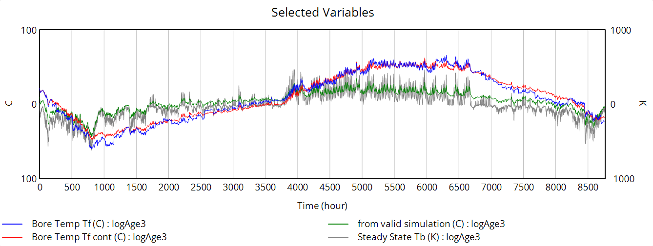

I tried tidying this up a bit with a dynamic differential temperature, but the parameterization is not simple to achieve a match. The upward or downward trend is still absent.

Ts is the time scale constant for normalization of time in Log(T/Ts). I got the big value from your spreadsheet.
In the new model, Ts is about 4 billion, which seems impossible.

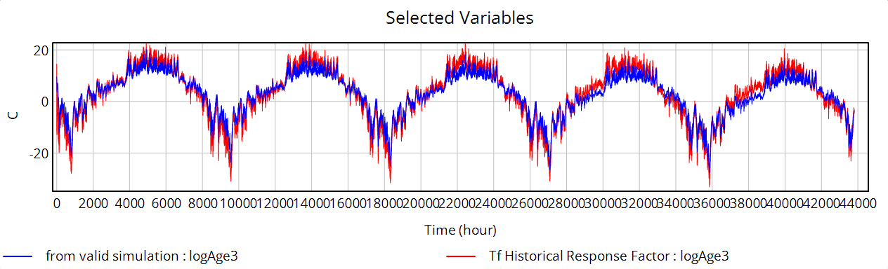

Yes, ts should be a very big number. When you asked this question, it prompted a bucket of bolts to break loose in my brain. I do see that t, of ln(t/ts) is in hours, and it should be the equivalent seconds. So, it appears that it was not ts that was wrong, but t itself. I have added the variable seconds in hour to the model run. I have not run any RMSE or tuned the dT values, but there is a much better visual match now. The trend also clearly appears as a depletion of the heat source over time with a peak operating temperature of 23C in year 1 and a peak operating temperature of ~14.5C in year 30.
