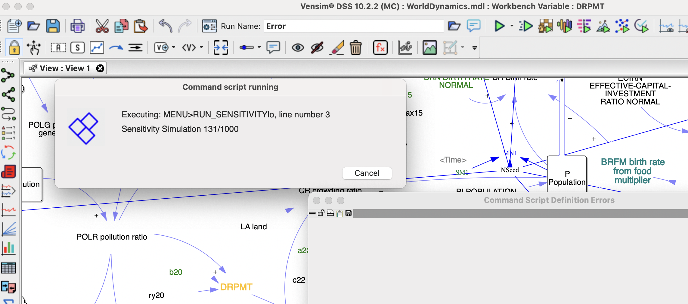

I was running a sensitivity analysis through CMD and noticed that I had a CIN file set in the simulation configuration. Vensim got stuck when I clicked on cancel (the animation is still running and the OS doesn't say that Vensim is not responding). Just waned to let you know. Here's the CMD:
SPECIAL>NOINTERACTION
SIMULATE>RUNNAME|Sens_v01
MENU>RUN_SENSITIVITY|o
MENU>SENS2FILE|Sens_v01.vdfx|Sens_v01.tab|*#
I used it by opening it from within Vensim. I think it should be replicated using any model.

I *think* this is fixed in forthcoming 10.3, but I'll double-check.

ok, I tried this on Windows, it fails as no VSC/savelist are provided.
If you can zip the model and files needed to run this and email them to us (vensim@vensim.com), we can take a closer look.
