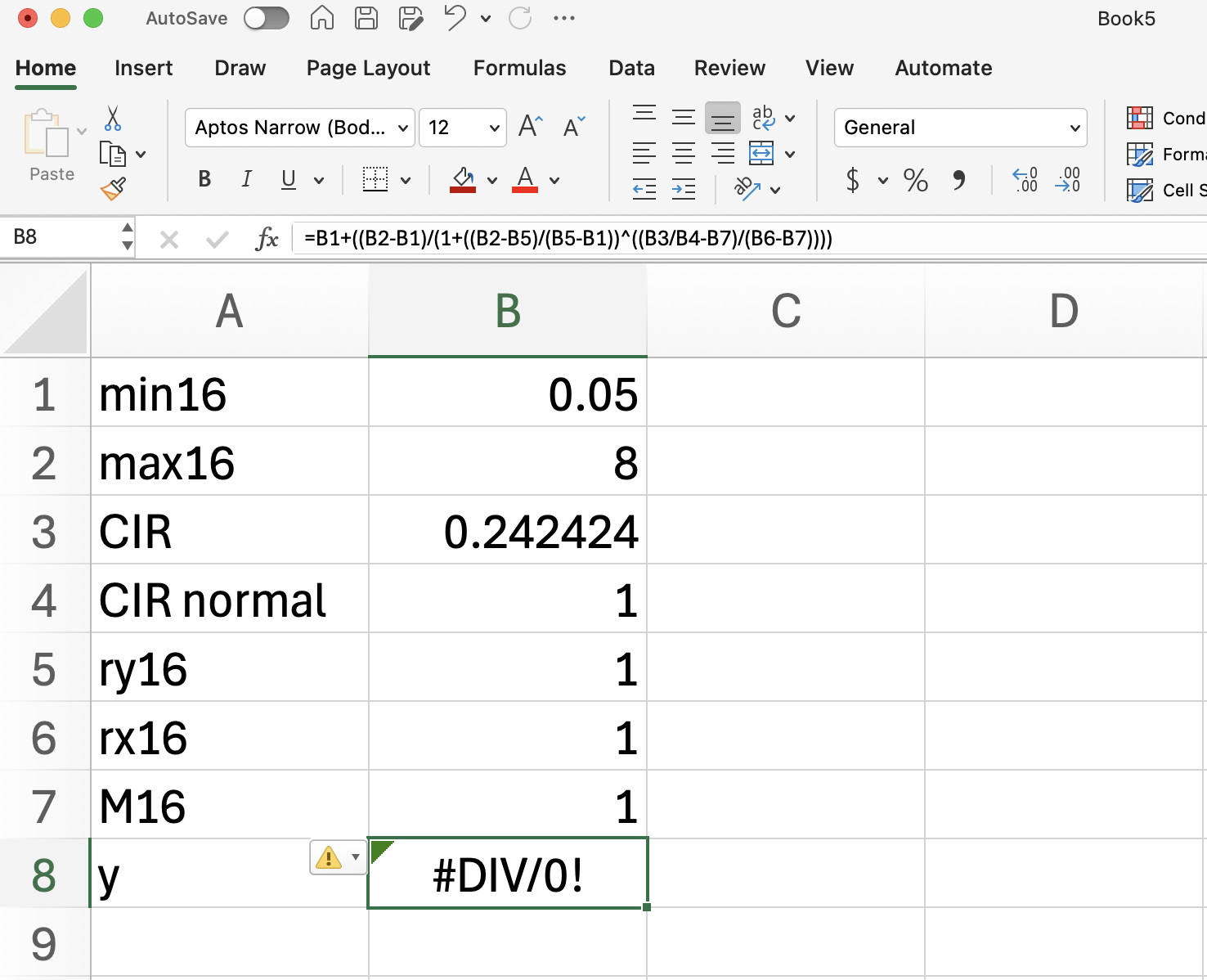

Also, note that the same equation and parameters throw a division by zero on Excel on Mac!

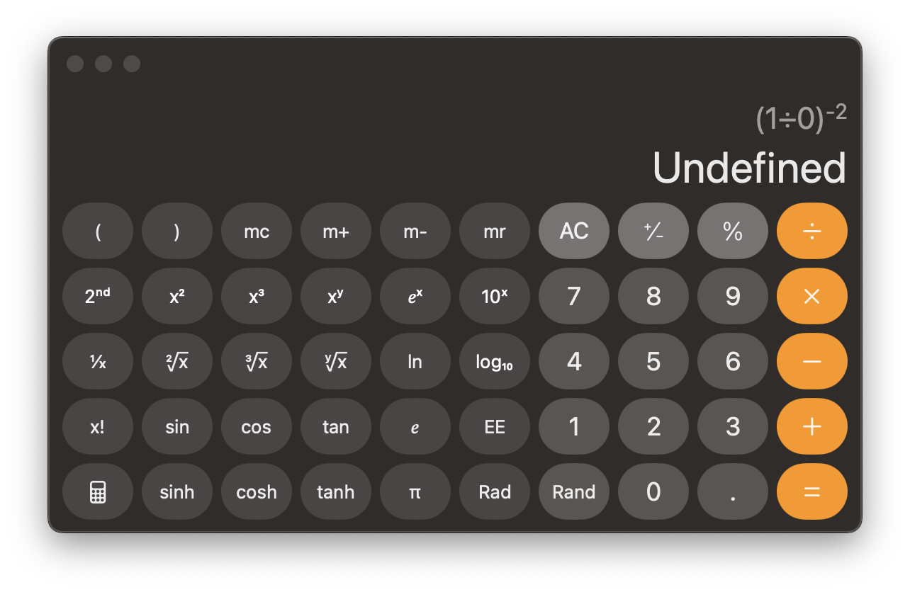

FYI, I crated the simplest test: (1/0)^(-2).
See this:
https://youtu.be/r7-pexr-Nd4
Finally, I'm not an expert so I can't tell if Excel or Calculator use the same libraries like Vensim for such operations, but Vensim is the only application that generates this unusual behavior.
