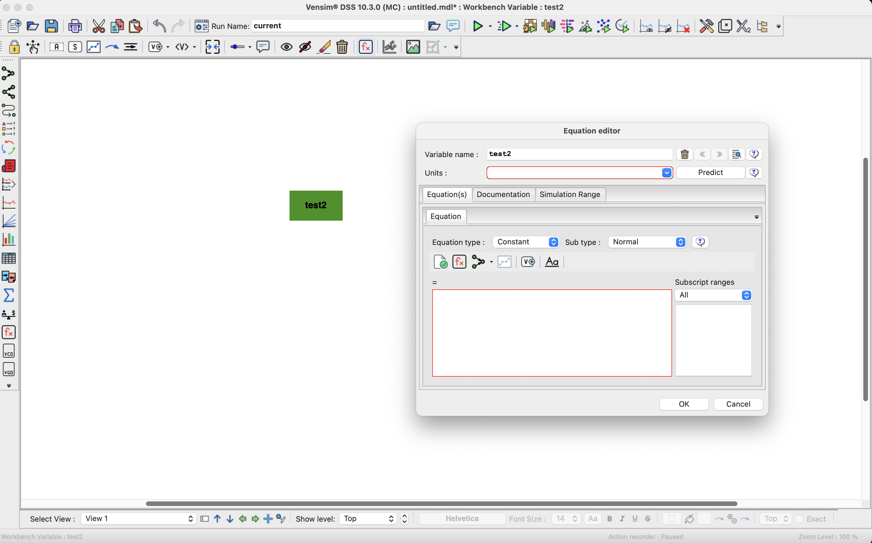

Equation editor seems to get activated but nothing shows up
Screenshot 2025-03-13 at 9.39.27 AM.png (1.07 MiB) Viewed 3483 times

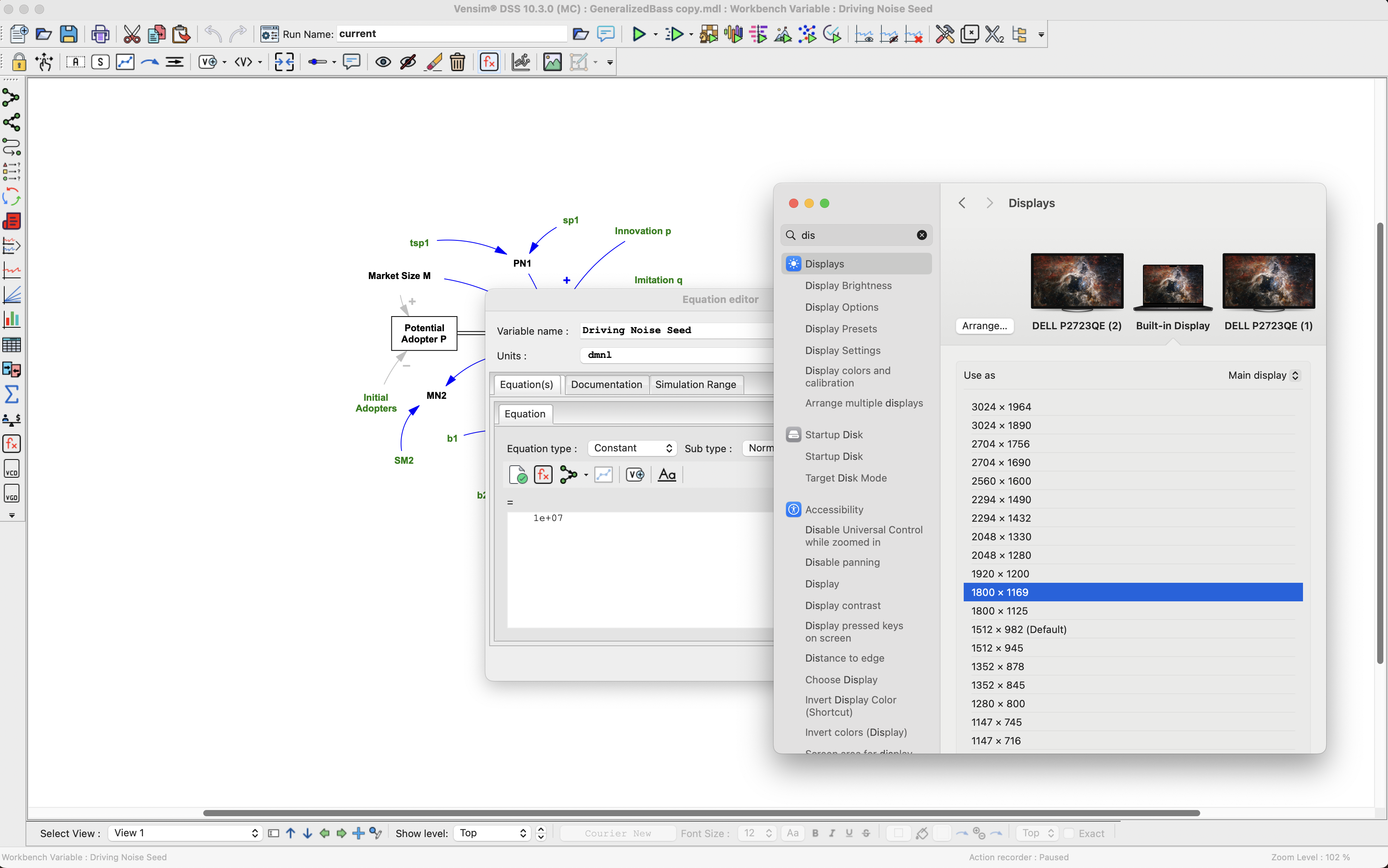

When the equation editor was open (and it was not showing up), I changed the resolution and it suddenly appeared!
Screenshot 2025-03-13 at 9.52.11 AM.png (1.78 MiB) Viewed 3469 times

And it now appears in the default resolution. I guess for the very first time it was outside of the display area (all displays).
Screenshot 2025-03-13 at 9.55.20 AM.png (1.19 MiB) Viewed 3469 times
it's all set now. Thank you!
