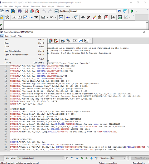

I just got de Vensim DSS version so I can use the Venapp. However, I have some trouble finding everything.
I started with the Template Venapp that comes shipped with the Vensim DSS. I found the venapp text editor and I could open the Venapp text editor. However, there I got a bit lost. I understand that this is the text file, but how do I from here run the Venapp or reach the described editor where you can sketch and switch between text/sketch. I tried to look for the file>run venapp, but couldn't find it (see attachment).
I'm probably missing something very simple. Hopefully someone can help me out.
Thank you!

- vensim help.png (197.05 KiB) Viewed 5450 times

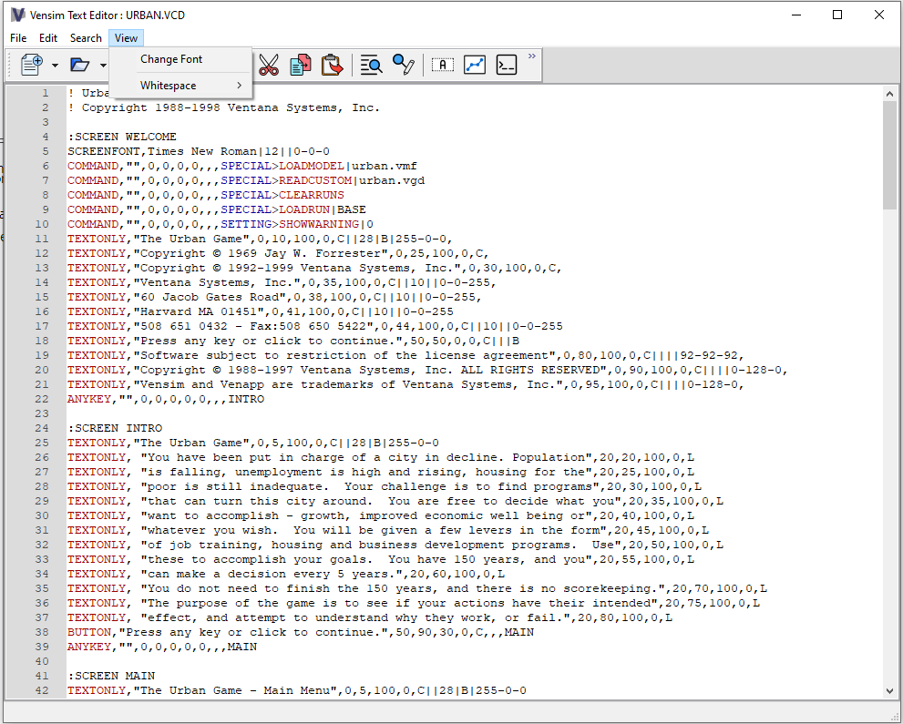

If it is any help, I also checked for the view>view as sketch/view as text.
I also didn't see anything there that could help. (but probably it's the same issue)
- vensim help2.png (83.6 KiB) Viewed 5388 times

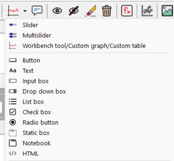

I only haven't been able to figure out how to add the GUI elements myself. Where can I find them?
- Posts: 4847
Re: Venapp help
On the sketch toolbar.
