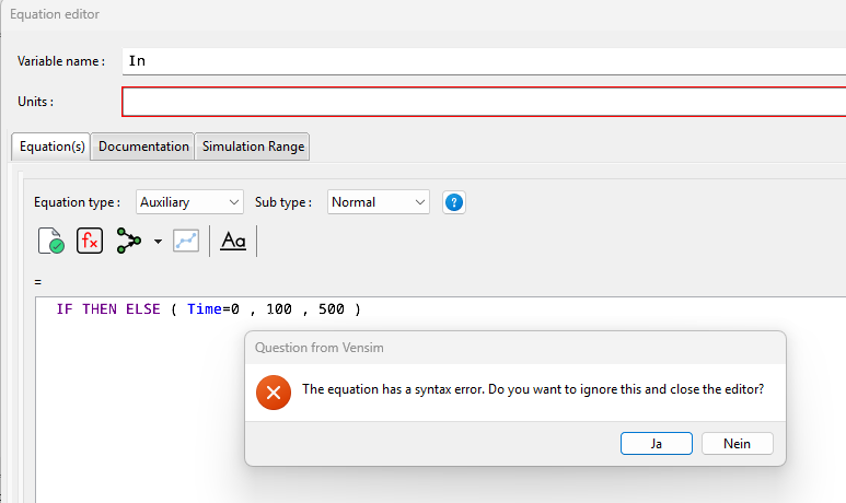

In a model I'd like to have a variable changed at a certain simulation time. However, " IF THEN ELSE (Time >15 , 1000 , 0 ) " for a normal auxiliary gets me a syntax error. My model runs from 0.0 to 100.0 months, time step = 1, Euler in Vensim PLE 10.3.1. Is the idea to use the internal time variable wrong, do I have to use a step or pulse function?

Thanks for your quick response.
It says "The equation has a syntax error. Do you want to ignore this and close the editor?" in the Equation Editor.

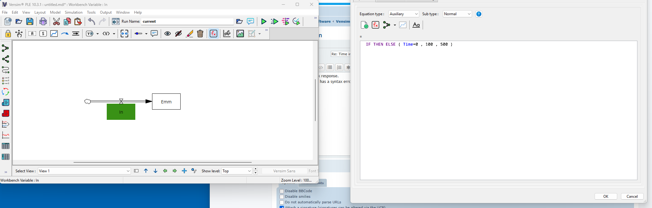

Try adding time to the sketch using the shadow variable tool <V>. Then draw an arrow from time to your auxiliary. Does that fix things ?

Re: Time in function

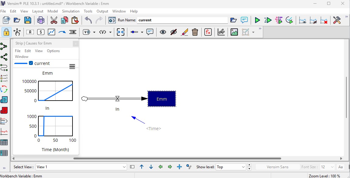

Yes, after adding Time as shadow varaible and re-entering in the equation editor by setting time from the list of available variables it works as I expect it to do.
Just one more:
In the model version without time as shadow something is starnge:
- If I use the legacy Eqution Editor and do a "Check Syntax" or "Check Model" no Error is reported.
If I do a "Check Equation" in the new Equation Editor oz says "Syntax apperas OK, but the equation has unused inputs or variables that are not an input"
However, If I want to close the new Equation editor the syntax error message appears.
Whatever causes this behaviour... I just work around by unsing the shadow variable Time and everthing is fine.
