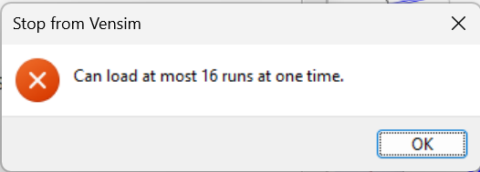

Hi all,
I am running simulations with the Run Configuration manager. Unfortunately, when the number of simulation runs exceeds 16, I get a display warning that stops all subsequent simulations from running until I manually click 'ok'. Is there a way to suppress this warning message so that the simulations will keep running without having to babysit the machine?
Screenshot 2025-07-29 184314.png (19.88 KiB) Viewed 5245 times

Re: Suppress model load warning in Run Configuration
Post by geo_curious »
I resolved this. The "Clear Runs" checkbox in the Run Configuration manager appears to fix this. I take the meaning to be 'clear runs from the loaded control panel tray'.
