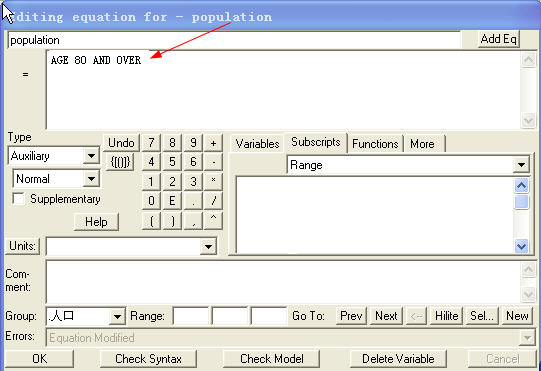

Equation use the subscript as the element?
lynchyml
Posts: 70
Post by lynchyml »

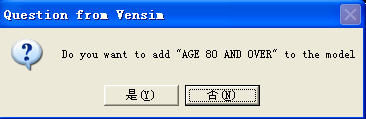

then it will ask:

if I said yes, it will automatically add a new suscript in <subscript control>.

Posts: 1107
Post by bob@vensim.com »
This will not happen, if that is what you are asking. If "AGE 80 AND OVER" is a subscript element then population will be equal to its ordinal value (eg 80). If it is not in the model it will be added as regular variable.
